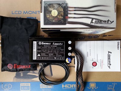

Reply 19 of 24, by Radical Vision
Yeah as im using 400W EnermaX Liberty on my 462 machine where it have ATi Radeon HD3850 AGP and Clocked AthlonXP-M on 2.6GHz rock solid...
