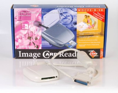

Similar but for a different format, there have been Compact Flash card adapter for the parallel port sold at retail, like this one that i have, and with DOS drivers working on XT computers:

Wow Parallel port CF card reader... I could totally use one of those. I had somehow never thought of such a thing.
I just looked them up and I'm seeing a huge price variation and a lot of different models. Not many of them mention DOS though.
How likely is it that they all use generic parts and would all work with the same DOS drivers? I'd love to get one, but I'm not spending a whole bunch of money it, especially if I can't verify DOS compatibility.
EDIT: Also, the biggest question I have would be, what are the REAL system requirements for something like this under DOS?
https://www.ebay.com/itm/DATAFAB-Image-Reader … vUAAOSwwI1ahvqn
I see it lists a 486 33, DOS 5.0 and 8MB of RAM... for a card reader. Is it even remotely possible to attach something like this to a much older computer to transfer the contents of the hard drive? Like, an IBM 5150 for example? That's what I would mainly use something like this for... backing up "large" amounts of data from systems that are limited to floppy disks.
I also have a couple of Parallel port CD burners but I highly doubt they would work for such an old computer due to the complexity of burning data to a CD without it getting corrupt in the process.

I'm using mine on a XT with a 8088 cpu, 512k of RAM, DOS 5 and the parallel port of the Hercules compatible card.
That model you linked to is an earlier model but uses the same drivers, so it should work fine on your 5150.
No idea about the models from other brands, like SanDisk ImageMate for example, best way to try would be to find the drivers and see if they run on your machine.
