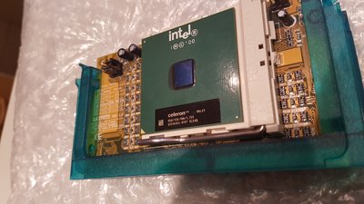

Reply 13 of 19, by Baoran
I have exactly same P2B rev 1.02 motherboard and I was not able to get this 100Mhz FSB CPU to work when I tried it couple years ago.

Reply 14 of 19, by Skyscraper
That slotket dosn't seem to have VID selection so the motherboard refuses to start because the motherboards VRM circuit dosn't support 1.75V.
With a slotket with VID selection you can tell the motherboard to provide a supported voltage, in this case 1.8V or more.
The MSI 6905 Master slotket can be found for little money on the auction site we shouldn't speak of.
