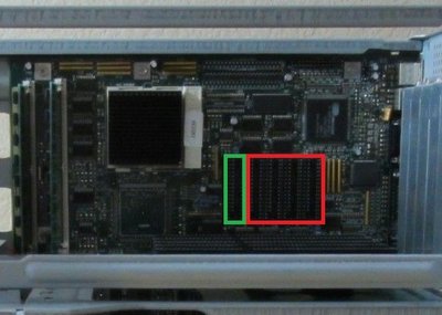

If Tag SRAM chips are the same thing as cache chips, then could I take 5 MT5C1008 (SRAM, 128K x8 DIP32) chips and put them in all 5 cache slots.
I wouldn't have to worry about only installing 4 MT5C1008 (SRAM) along with a separate IS61C1024-20M (TAG Chip DIP32).
The red denoting locations U15, U19, U24 and U30 where cache chips go, and green denoting U35 where the tag SRAM chip goes.

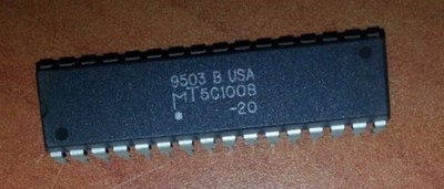

Very true. At any rate, I bit the bullet and purchased a lot of 11 of these...
56.9 KiB
803 views
They're 20ns so it fits the profile. PB wanted you to have 15, 20, or 25ns for cache.
I'm also going to get a 10 count of 32kx8 15ns cache. It will only give me 128k of cache, but if the 512k doesn't work out, I have something to fall back on.
