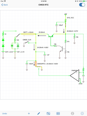

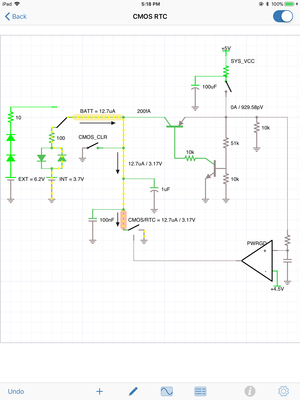

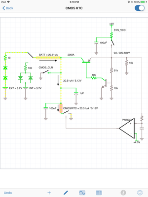

Just to illustrate the description from my previous post, here’s a typical circuit for the CMOS/RTC Battery on 286/386/486 class motherboards that I whipped up in a simulator. It shows three states: External and Internal Batteries with the Power Off and Internal Battery with Power On (o show charging).
The CMOS/RTC is represented by an analog switch that presents a 250kOhm Load when off (simulating the standby current) and a 250 Ohm Load when on (simulating normal current draw). The comparator represents the Voltage Supervisor IC present on most boards and puts the CMOS/RAM into standby mode when System Power drops below 4.5V (in this simulation it’s used to control the aforementioned analog switch).
[attachment=0]362C3F19-638E-4D2A-8974-6C1960FDBDBB.png[/attachment]
[attachment=1]41A11CC1-7ABC-491A-8341-E09C917B2008.png[/attachment]
[attachment=2]AE36C274-58A4-4CDE-99E5-D3B109E24E63.png[/attachment]
Power Off, External Battery
Power Off, Internal Battery
Power On, Internal Battery
