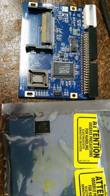

I have two of the aztecmonster SCSI to CF interfaces I purchased in 2015 for use in older macintosh computers. Long story short, I only used one and left the other in the static bag til last week when I finally got my hands on a Mac SE. Opened it up to use the 2nd adapter and the computer would not see the interface. Disconnected the SCSI cable, hooked it back and it was there, then it was gone again after the next reboot. Very inconsistent behavior. Since I had two adapters I could do some general troubleshooting and found out that the problem followed the adapter, and nailed it down to the BIOS flash chip itself. I could pull the winbond chip from the bad adapter and put it in the mac that has been working flawless for 3 years and it now would give me the blinking disk symbol, and the new adapter that wouldn't work consistently booted every single time. So this makes me feel pretty confident that the flash chip is bad or corrupt.
I have contacted the company I bought these from, but so far the exchange hasn't been encouraging that they even care, stating that this product is discontinued and thus no support. Since I have one working unit and one bad, can I buy a EEPROM programmer and read the good chip to a file and then write that to a new flash chip? Is it possible they have a read lock or something that would prevent this? I am unfamiliar with flashing chips other than through a DOS utility, so forgive me.

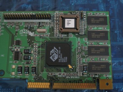

Thanks for the replies guys. Interesting I didn't think of being able to use a NIC to program a chip. I found a motherboard that has the PCLL32 socket for it's BIOS in my immediate parts, but if I pull the existing ROM how would I run a program to read the good chip to a file? I will go up to the attic and see if I can find a NIC. I am located in SE Oklahoma
Reply 5 of 15, by lowlytech
Well I hit a wall pretty quickly. Only card I could find was an AGP ATI Rage with that socket, however I don't have a single AGP motherboard to install it in. Only have one PII, and one PIII board and they both have integrated AGP video with only PCI slots. Guess I will start looking into programmers.

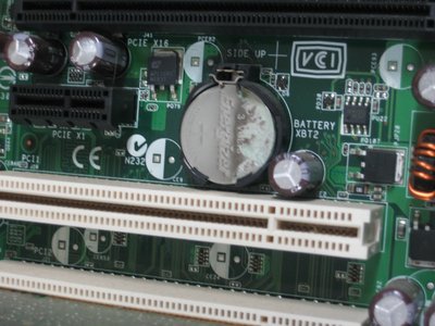

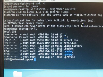

Reply 11 of 15, by lowlytech
Have an update. I opened up my older file server I used before switching to freenas last year as a last resort, and low and behold it had an intel nic with the PCLL32 socket. It also looks like my old server has a leaking CR2032 battery which is a first time I have ever seen that 😐 I got xunbuntu loaded up and got the 1.00 flashrom installed and it seemed to read my good flash chip without issue. However the file size is 65536 and nowhere near 512K. I assume flash is just like any other storage medium, you can have bigger than your file your trying to write? Just incase I read the chip twice, 2nd time with verbose enabled to make sure there were no issues and it did detect the chip as winbond W29E512.
After I got the flash file read, I shut down the system and for giggles thought I would put in the flash chip from the CF reader that has been giving me trouble. Flashrom would only give the error that No EEPROM/flash device found. I reseated the chip several times and just kept getting this same error. Guess it is safe to assume this chip is just bad somehow?
One last question for lazibayer or someone that is more familiar with flashrom. In a previous post I have a GLS29EE512 that I am going to order, however this specific flash type isn't listed on flashrom's supported chips. In the datasheet is seems like this chip use to be called an SST, but not anymore. Will this give me problems or do I need to find a different Flash chip to order to be able to write this file back?
Thanks again for all the input and suggestions, I never knew this flashrom program even existed.

lowlytech wrote:
Have an update. I opened up my older file server I used before switching to freenas last year as a last resort, and low and beh […]
The number "512" in the chip's model is measured in kilobits, so 512 kilobit = 65536 byte, no problem here.
Sounds like your bad chip is just ... too bad to be reformed. 🤣
I just checked the datasheets of GLS and SST chips and they both have the same chip id: BF5D, so it's quite possible that Flashrom will take the GLS chip as if it's an SST one.
Also you can try to reach the authors of Flashrom; they have been quite responsive and helpful to me over the years.
