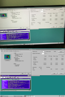

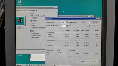

When I ran the 7zip Benchmark, I recorded 12MIPS.

This is the record before installing the cooler.
Compared to the 10MIPS before the cooler, 12MIPS after the cooler has been improved by 20%.

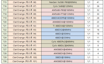

This is my 7-zip Benchmark chart. 12MIPS is better than Intel 486DX-33MHz.
The reason for the 486DX 50MHz and 486DX2 66MHz results is the same because 50MHz is the DX-50 of FSB 50.
It is not DX2-50.
All CPUs in the list except nx586 have been tested in the same environment.
because Nx586 requires a dedicated motherboard.

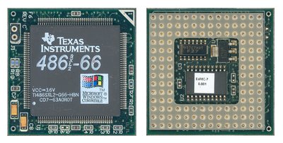

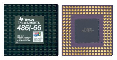

Also, why do these QFP144 TI486SXL2-66 chips all seem to come without a heatsink, while the PGA168 versions of the same chip have a heatsink? Were there any clip-on QFP144 heatsinks I can use on this thing? Or some other wild z-clip type of thing? Do they not need a heatsink at 3.6 V? I was thinking about removing one of the heatsinks from my PGA168 SXL2-66 chips and using it on the QFP144, but I still wouldn't want to use thermal epoxy.
