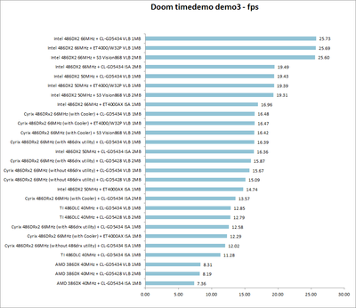

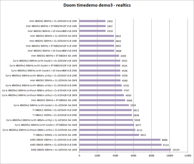

i will add new Doom benchmark data.
feiipoa seems to be interested in the performance difference of the VLB / ISA graphics card under the 486DRx2-66 CPU environment.
It was measured in environments that measured performance two years ago. ( Post your 386 Speedsys results here )
I have benchmark 3 CPUs. and

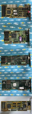

5 VGAS.
1. Tseng ET4000AX ISA 1MB
2. CL-GD5434 ISA 2MB
3. Tseng ET4000/W32P VLB 1MB
4. CL-GD5434 VLB 1MB
5. S3 Vision868 VLB 2MB

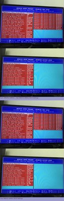

spec is
CPU1 : Cyrix 486DRx2 66MHz (L1 WT,L2 WT) (386 Socket)
CPU2 : Intel 486DX2 50MHz (L1 WT,L2 WT)
CPU3 : Intel 486DX2 66MHz (L1 WT,L2 WT)
RAM : 16MB 60ns (4MB x 4)
M/B : Aquaris MB-4D33/50 3/486 VLB Motherboard (OPTI 495SX)
I/O : Promise EIDE2300 VLB E-IDE
HDD : PQI DiskOnModule 2GB E-IDE
1.78 MiB
809 views
789.85 KiB
809 views
Speedsys data. Pic 1,2 is Cyrix 486DRx2-66MHz, Pic 3,4 is Intel 486DX2-50MHz, Pic 5,6 is Intel 486DX2-66MHz

Nice! 21.4% increase when going from the ISA to VLB version of the GD5434 on the DRx2-66, or 11.3% increase on the AMD 386DX-40.

Finally, somebody published Vision868 results. Now that I see it's on par with GD5434 and ET4000W32P, I don't have to waste more time looking for one.
