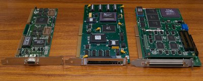

As you can see, one of them is a Tseng VLB card, and I could only be certain that it is a Tseng ET4000 VLB, of at least W32 as it has two empty memory sockets. There is also a single board computer with the 486 processor that I was searching for, an Intel 486DX4 100MHz SK096 with write back cache, and finally another communication card containing a TI DSP chip. It appeared that the Intel CPU was soldered to the board.
Whilst the asking price was $134, I made an offer for $50 with the offer notes saying that I wanted only the Tseng card, which the seller had accepted. When I tracked the item being FedExed, the seller put INTERFACES (notice the plural) as the reference with the weight of 3lbs, which meant that I were getting all three cards for just $50!
Once received, I am a happy customer, with not only a Tseng ET4000/W32p VLB card, I also received a communications card with a TI DSP chip and a single board computer with an Intel 486DX4 100MHz SK096 processor with write back cache. However, the Intel CPU is soldered to the board, but I already have another SK096, which the seller managed to desolder as there were still solder on the pins!
1.13 MiB
1326 views

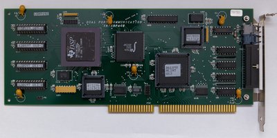

1.41 MiB
1326 views

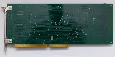

1.08 MiB
1326 views

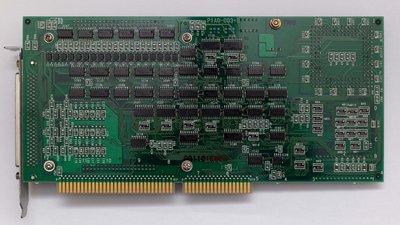

1.48 MiB
1326 views
I put an extra 1MB RAM on the ET4000, using the RAM extracted from a faulty S3 Trio, to get 2MB, put it in my 486 and it works!
The main question here is that what the other two cards do? I have tried searching online about them and could find no information. If ever I needed the 486 CPU from the single board computer, it would take a tremendous amount of effort to desolder it, as I have seen elsewhere on this forum.

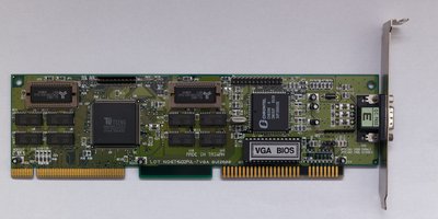

1.6 MiB
1324 views

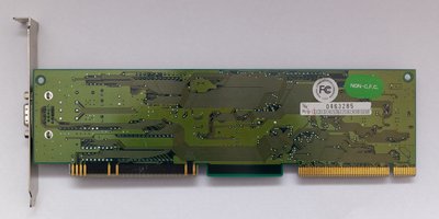

1.21 MiB
1324 views

Nachi is famous for making robotic systems and the card looks like a controller that communicates with the robots. Not sure about the Ti card but I reckon it's used for interfacing with some industrial equipment.

I am relatively confident that Tseng card was sold by JDR Computers at one point, as one of their house brand products, or perhaps as MCT (Modular Circuit Technology).

I'm 99.999999999999999% sure that that board with the 486 chip on it is not a standard SBC. I'm guessing it is some sort of control module for some manufacturing equipment. Looks to me like it is for some robotics equipment as was mentioned above.
Do a search for what an actual 486 Single Board Computer looks like on eBay.

I have now acquired an EPROM programmer after many months and now dumped it's contents which I attach.
It is a 1Mbit (128Kbyte) ROM, the first 512Kbit (64Kbyte) is completely empty (0xFF) and the other half does not have much in it, with lots of 'blank' areas, and definitely looks nothing like an average PC BIOS. Look at the compression ratio of the zip file! Therefore, you are correct that it was some sort of manufacturing equipment.
