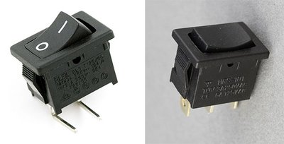

Reply 5 of 7, by Auzner
So it's a SPST toggle switch which has to be replaced with a momentary device.
There's probably a part which is the same style of switch but the mechanical is momentary. You'd swap it out then.
