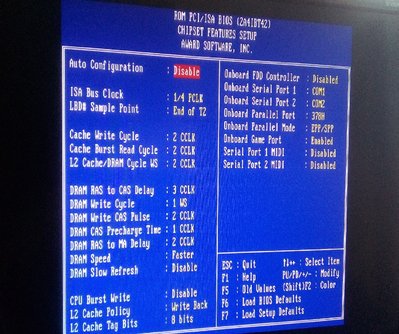

This sounds a lot like a bus speed issue, which means that those "CPU speed" jumpers are also doing all kinds of bus stuff. It also means that somewhere between the documentation you found and what you're doing on the board, something is working differently. At a guess, I'd say it's deriving the ISA clock from the PCI bus or CPU host clock with a divider, and that that divider should be 4 (33/4=8.14MHz) but instead it's maybe on 3 (intended for 25MHz, but at 33MHz that gives you 11MHz) or lower.
As for how to fix... well, if documentation fails, you're left with trial and error. Change the jumper settings one by one, and look for a setting that does *not* seem to change the CPU speed. Once you've found that, test the sound card. Or better, find a diagnostic tool that shows you ISA bus sped.

I couldn't find an isa-bus speed diagnostics program. Although if anyone knows one, please send it my way 😎
The only options i have for ISA-Bus-Clock are:
1/4 PCLK, 1/3 PCLK, and 7.159MHZ (<--- this makes things worse)
Playing around with the only related jumpers just produced the motherboard displaying an inccorect cpu-main speed, unless i had ALL the bus jumpers covered (even if the only manual i can find shows diffrent bus jumper layouts for diffrent speeds)

Very mixed results. Iv included a picture of my current ISA-bus setup in the bios.
Once again, disabling cache to slow the cpu got everything working 100%.
