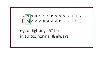

And can You help with turbo LED display ...how to cinfigure jumpers 33/66

Reply 2 of 6, by konc
Your led display follows the common approach. Read this to get an idea how these displays are configured in general and then experiment with yours:
http://www.amsky.com/~cirkuit/comptips/speddisp.html
Here's an example for a single "line", it might help you grasp the logic easier

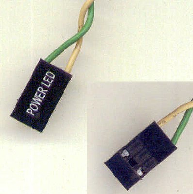

Reply 4 of 6, by Cadderlik
No I mean J13 Keylock and Power Led - as it is in manual.
There is said pin 1 - power, 2 - spare (what does it mean?) , 3,5 ground 4 - keylock
J11 is for reset button and it works ok
I have double (red and black cable) power led plug from my case panel - should I put in pin 1 and 3. For what is spare pin 2?
Reply 5 of 6, by PARKE
It is not uncommon that the middle pin of a 3-point power led jumper is not connected, the corresponding [edit] Dupont plug could then look like this:
