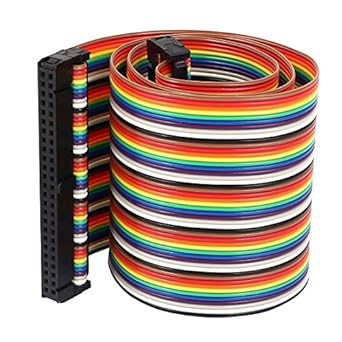

Let's just say I got a nasty lesson in what SCSI termination power from a hard drive with an IDC-50 cable plugged the wrong way around will do when testing out my Amiga 2000 for the first time.
Since the A2091 SCSI controller board isn't keyed (which is downright STUPID, since I misread the PCB initially), there's nothing stopping you from plugging it the wrong way around (hint: the marked pin on the ribbon faces toward the BOTTOM of the case, not up!), and the drive that was included (some kind of thick 4 GB Seagate Barracuda) had a crapton of termination and power-related options on the jumper headers. More than I knew what to do with, really.
Cue the sudden onset of smoke and a nasty burning smell that hasn't gone away as one of the middle conductors of the cable just straight-up melted its insulation... and I thought IDE/Parallel ATA was a pain in the ass!
Reply 45 of 76, by bjwil1991
An IDC-50 cable is a 50-pin SCSI cable that was commonly used on older SCSI Hard drives, CD-ROM drives, tape drives, you name it. Those cables also required a termination adapter on at least 1 header to make sure the drive can be reached since SCSI back then relied on termination adapters to make the drives detectable, and without it, the drives won't work or get detected. IDE drives are easier to work with, but SCSI drives power on once the controller turns on. Here's a cable:
Reply 47 of 76, by bjwil1991
Back then, there was no keyed I/O ports (serial, parallel, IDE, SCSI, FDD, etc) that had the plastic housing around the pins themselves to avoid confusion of how to install the cable. My Packard Bell Pack-Mate 28 Plus luckily has 1 pin missing on the IDE and FDD ports (common for OEM systems to do that) so that way I can replace an IDE cable with a modern one that has the one pin (unused) that's covered for the correct orientation. I did hook up an HDD and ODD incorrectly once, but nothing bad happened, and I was quick at the power button and power strip.
