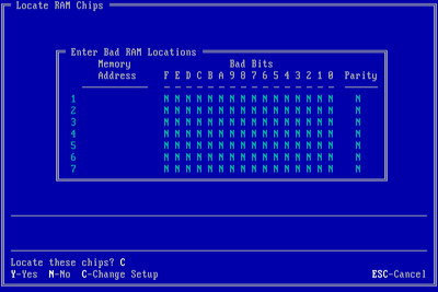

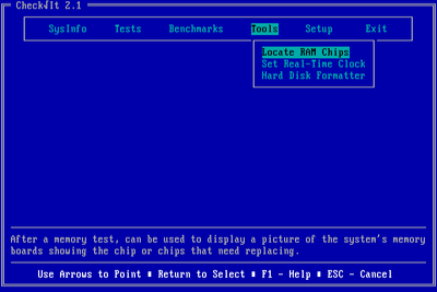

Reply 2 of 4, by Jo22
Hi, CheckIt! also had a memory test feature that would assist in this case.
Haven't really used it before, though, so I can't say much about it (I'm still learning about XTs).
    22.23 KiB
    494 views
    19.92 KiB
    494 views

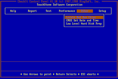

Reply 4 of 4, by Jo22
Errius wrote:
Is it safe to be running memory testing programs in faulty memory? How does CheckIt protect itself from getting corrupted? (SpinRite immediately shuts down when it detects bad memory.)
I'm not sure if I can answer that, I'm sorry. 🙁
The original CheckIt! called that test "Locate Bad Ram Chips", though.
    25.34 KiB
