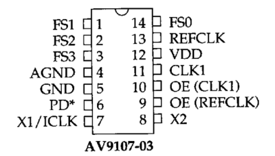

I have a 486 motherboard that I have to put jumpers right for its new CPU but when I look at these 3 jumpers with 3 pins each I cant figure out which ones are pin 1 for each, I have some pictures here of the motherboard with the jumpers:

but it is not the same exactly as mine for JP34/JP35/JP36 in the manual they only have two pins and on my mobo they have 3 pins and are in a different location.

I have two more pictures of under the board and I see there are 2 circles and one square for each of the jumpers so would each of the square ones be + or pin one?

Your board uses AV9107-03CN14 clock generator.
file.php?id=31862&t=1
32.09 KiB
186 views
My deductions:
Pin 1 connects to 5V
Pin 3 connects to ground
Pin 2 of JP36, JP35 and JP34 connects to FS2, FS1 and FS0, respectively.
You can use a multimeter to confirm these.
