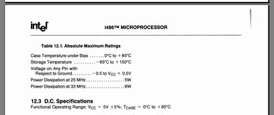

Operating temperatures are lot lower than storage temperatures which are usually 125....150ºC range.
Reply 21 of 24, by PCBONEZ
Good point.
Storage Temp was missing in the table looked in.
Didn't even occur to me to look it.up.
42.44 KiB
395 views
By that I'd say boiling is safe enough. - Personally I still wouldn't do it.
Dry very well.
Be aware that thermal shock might crack the ceramic package.
If it's the same stuff I dealt with I don't think it will work, but what the hey.
