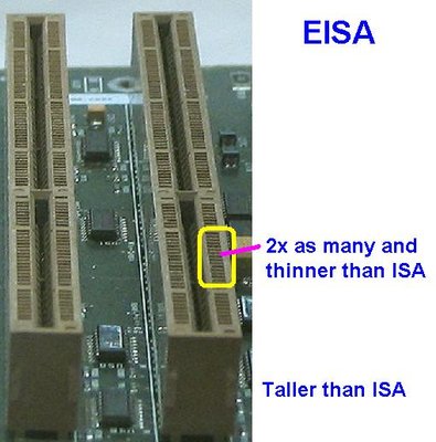

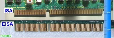

Reply 47 of 66, by PCBONEZ
Baoran wrote:
Eisa cards are so rare that I don't think I have ever seen one. Does an eisa version of the I/O and video card the computer has even exist?
I looked at Ebay.
There are all manner of EISA I/O cards and 3 video cards. Probably others, didn't look.
It was bugging me hoe they could have 16 and 32 bit in the same slot and how to tell the difference.
Since yawetaG didn't answer I poked around until I figured it out.
Can't tell with 100% certainty from the photos but it looks like your slots are EISA but your card is just ISA.
What they did (over ISA) was make the slot connector deeper and add a second row of pins below the ISA pins.
Visually this means the little holes along the top edges of the slots are 2x as many and smaller on EISA.
Also the card edge fingers are thinner and the edge taller.
Pretty easy to ID once you know what to look for.
(All the folks that haven't forgotten all this are prolly laughing their butts off about now... 🤣 🤣 🤣

Reply 54 of 66, by PCBONEZ
dionb wrote:
PCBONEZ wrote:
I looked at Ebay. There are all manner of EISA I/O cards and 3 video cards. Probably others, didn't look. […]
I looked at Ebay.
Er, he did you know, it's all in that link he posted earlier and no one bothered to read. No wonder he frustratedly left in a huff...
I did look at the link.
There is nothing in it that explains how to tell the difference visually.

https://en.wikipedia.org/wiki/Extended_Indust … rd_Architecture
The EISA bus slot is a two-level staggered pin system, with the upper part of the slot corresponding to the standard ISA bus pin layout. The additional features of the EISA bus are implemented on the lower part of the slot connector, using thin traces inserted into the insulating gap of the upper / ISA card card edge connector. Additionally the lower part of the bus has five keying notches, so an ISA card with unusually long traces cannot accidentally extend down into the lower part of the slot.
Also:
"ELSA Winner 1000 for ISA and EISA"
Reply 57 of 66, by PCBONEZ
Sure, AFTER you know what to look for it's pretty obvious.
Just posting a link to Wikipedia with no explanation didn't help anyone that didn't know what to look for.
(As evidenced by the way the conversation went afterwords.)
