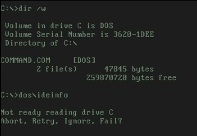

So I've already tried a lot of different things to get my 256MiB Compact Flash running in my 286 machine.

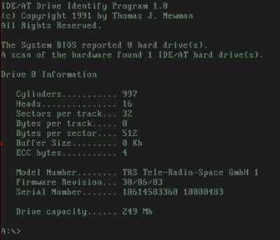

I have a 256 MiB Compact Flash that identifies as 249 MiB with IDEINFO.exe, see attached screenshot. I am inclined to believe this data, because why not.

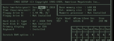

You can also see the values that I entered in BIOS. I can partition the disk using fdisk from DOS 5.0, and format it using "format c: /s". I can also copy stuff from the floppy to the hard disk. However, when I try to read it, e.g. by executing IDEINFO.EXE -- or any other program -- I only get "drive not ready" errors.
I have tried different HDD controllers as well, one LCS-6624G, one UMC82c865 based and one WinBond card. All behave the same. So I am basically out of ideas here. What am I doing wrong? What else can I try?

IDEINFO drive geometry

Drive not ready error

CMOS setup

Reply 1 of 3, by Jo22
Good evening and thanks for the screenshots! Seems fine to me. 😀
You like to try if changing the Head value to 15, LZone to 997 and see what happens.
