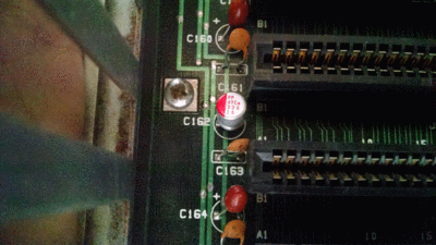

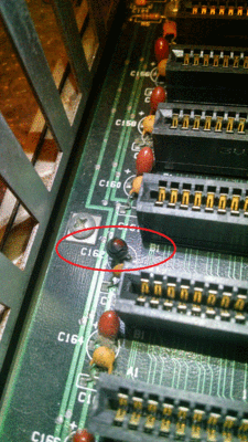

After all these years my very first computer finally bit the dust. Powering it on tonight gave the snap, crackle, pop and smoke I am sure many here are familiar with.
I am looking to get some help now identifying the part that appears to have failed in the hopes that I can replace it and bring the ole girl back to life.
Thanks in advance for any assistance that you can give.
Reply 1 of 13, by bjwil1991
Looks like a tantalum (tantrum) capacitor that went up in smoke. Welcome to the forums. Also, looks like the other red ones might be the same Microfarad and voltage. I would replace all of those caps if I were you since their days might be numbered as well.

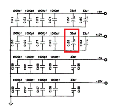

I did find an old technical reference manual for my Tandy 4000 online here:
ftp://ftp.mindcandydvd.com/pub/tvdog/other_ta … x86/4000trm.pdf
On page 150 of the pdf there looks to be a schematic for the AT bus which looks like what I may be dealing with. In the lower right hand corner there appears to be a label for C162 which looks like the part that failed. I'm assuming based on what I see there that i may be looking for a 12V 33uf capacitor. Does that sound/look right based on the schematic?
If so if there a specific type or material I should be looking for in that capacitor?

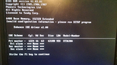

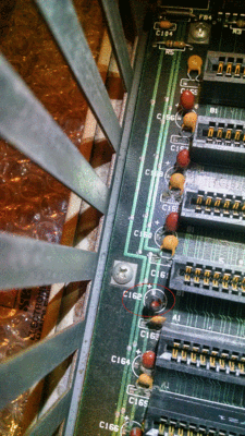

Received the replacement caps and just finished installing them. VIOLA!!. The old girl lives again!! I really appreciate everyone who helped me out with this issue. You guys/gals are the best!!.
