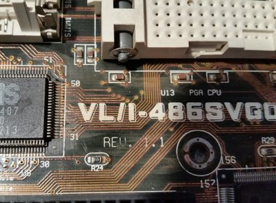

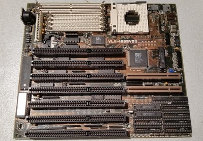

Hi,

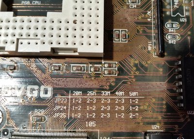

I was recently given this 486 motherboard which appears to be dead. The power LED lights, but I don't get any beeps when powering it up, which to me usually indicates a CPU problem (or worse). When I got it, it was covered in dust and so I was wondering whether the CPU socket just needed a good clean, but that doesn't seem to be the case.
There's also significant corrosion along the PCB tracks. I gently cleaned some of these to test them with my multimeter, and there was continuity... however I'm guessing that any one of those corroded spots could be a break.
I just thought I'd ask for opinions here though (because it's a good board). Has anyone had luck with PCB cleaners resurrecting a dead board? Or any other suggestions to try?
By the way yes I tried it with cache chips and also checked the BIOS. Another board I have can at least start up without cache chips so I didn't think that was going to help anyway. I've tried 3 different CPUs with appropriate jumper settings (all CPUs known to be working). I could feel the 486SX chip getting hot so something was happening... 😀

It seems the board has lot of corrosion, several of the vias on the photos look like they're no longer conducting. It would be possible to revive this board but it'll take a lot of work.
Reply 2 of 7, by Kubik
Hmm... If I was asked to fix (or try to) this board, I would also try the diagnostic card to see if there's any activity. The fact the board doesn't beep doesn't necessarily mean it's totally dead. I would also inspect (and eventually replace) all sockets that might get into touch with the corroding fluid. However, the chances to fix this one aren't too high. There might be some corroded trace under the CPU socket and removing it and fixing the broken traces would be too much of effort. The same for the chipset chip. Also the vias might be damaged.
While fixing Commodore PC-10's, I've also noticed that corrosion sometimes somehow gets into the chip itself - the memory chips next to the battery were all dead, while the memory chips farther away from the battery were all good. If the fluid got into that chipset...
I'm also surprised about the location of the corroded traces - did it have an external battery positioned over the board? Or where did that corrosion come from?

Then it depends on how much effort do you want to put into it 😀 Similar working boards just sold on eBay.de with CPU and memory in range from 30 to 40 EUR.
Anyway, if you still want to try, I'd recommend to try that diag card first. I've tried some and I can recommend this type: https://www.aliexpress.com/item/4-Digital-LED … 2860150439.html . Others I've tried didn't work at all, or didn't work reliably. If the card shows something, it might give you a clue of what you should do next.
While waiting for the card, try to reseat all the chips, especially the BIOS one, and check the socket and chip pins for corrosion. Replace socket if in doubts. Remove the cache, check the jumpers. Give the whole board a good wash in slightly soapy water, and use soft brush (preferably antistatic), rinse with demineralized water and let it dry well (few days, and on the sun if possible). If you do have an EPROM programmer, try to find working BIOS for the board and compare it with content of EPROM (EPROMs tend to lose content, especially in higher temperature environment).
Try a VGA card and see if it does something - and try all ISA slots (the ones next to battery tend to be dead sometimes). If you feel like that, check all the traces for continuity, including vias.

I tried one of those diagnostic cards (same as your link) - the reset LED lights continuously indicating a fault with the reset circuit... as if the reset button is pressed in all the time I guess, which is consistent with no beeps.
I'm assuming that wouldn't be an easy fix, if even possible. But maybe a more thorough clean would help, who knows.
