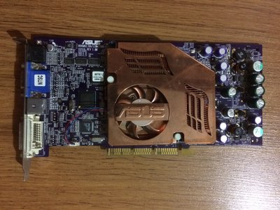

My PIII W9x rig, the retro machine that I used and loved most, originally had an Asus V8460 Ultra Deluxe )GF4 Ti 4600) and a Sound Blaster AWE64 Gold. Now both of them (actually two Sound Blasters AWE64s) have problems and not working.

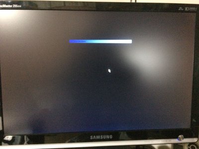

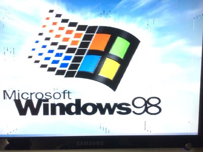

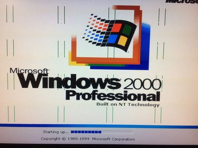

Yesterday, while making a routine cleaning, I dropped a screw inside the machine. It went missing into some place mysterious, and I took the machine up, hold it up side down and shake a bit strongly to drop the screw (it dropped). After putting back all the cables and such, I restarted the machine in Windows 98, but it hanged there just before going into the login screen. So I rebooted in safe mode, see a lot of artifacts, started to panic, rebooted it into w2k, and seen the artifacts there, too.
I took the card out, reseated, and it worked... for a while.... then the frozen windows in stupid monochrome like colors and artifacts again during restart. I took apart the cooler, cleaned and applied new thermal paste... artifacts again, hang during starting up windows again.
So I fall back to a Ti 4200, the machine works perfectly. There is no visual damage or caps gone bad. The below are the windows 98 and 2000 start up and 2000 login screens (98 juct hangs, so no login screen). Any ideas?

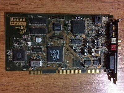

The problem with SB AWE64s is more easy to tell. The first one was working correctly one day, and stopped working the other day. BIOS did not recognize it as a PNP card during boot up. Actually it is not recognized by anything at anytime. Both computer and windows just behaves as there is no card in there. The second one was again working perfectly one day, then it started outputting sound from left channel only. There is nothing on right channel (of course I checked speakers and cables).
Either of these cards were beloved parts of my PIII rig. Now I had no spare AWE64s, so I fall back to a Value PNP. I think I can never afford one again with 100+ USD price tags.
Any ideas?

Reply 1 of 3, by chinny22
First thing to try is nothing. I've lost count on the times something hasn't worked, come back to it next weekend and its fixed itself!?
I'm guessing you've tried both in a different PC? Maybe its the motherboard being funny? or maybe simply moving everything around kicks them back to life?
Reply 2 of 3, by tayyare
The two AWE64 Golds are hopeless. I tried them in other machines, and other cards work correctly in that machine. For the Ti4600, I haven't tried it yet in another machine, but a ti4200 is perfectly working in the same machine right now. 😢
Let's see what will happen next week...

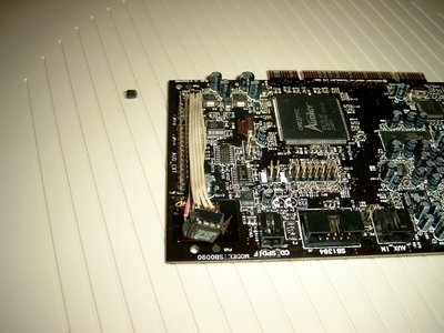

Just a thought on the AWE64 that became "invisible" - had this happen to a friend's SB Audigy, back in 2003 or so. Card disappeared from Windows, official Creative drivers wouldn't install (no Creative Soundblaster hardware found, or something along this line). The card worked with the KX drivers, but my friend needed the functions offered by the official drivers (SoundFonts I guess), so the card went to the store where he bought it for warranty. After a while they said they couldn't reproduce the fault and gave him back the card, useless as before. I searched the net, and found out he wasn't the only one with this problem: apparently the content of a small EEPROM from the board gets corrupted for whatever reason, in combination with certain other hardware (motherboard, chipset, bios, dunno).
I found a russian site/forum where they had dumps of a few Creative card EEPROMs, along with a schematic for a crude, parallel-port programmer and the needed software. Unsoldered the chip from the board, built the programmer, the chip was completely blanked (all FF or zeros, can't remember). Burned the correct code for that card, but as a measure of precaution i soldered back another EEPROM, this time in DIP package (to make reprogramming easier in case it gets corrupted again). The board worked perfectly after that, and it might still be in service 😀
Looking at my AWE64 Gold, I see at least one such chip (93C66)...
