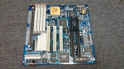

I work at an e-cycle warehouse, and the other day a BLUE baby-AT motherboard with an embedded Cyrix CPU came in.
I've tried different memory and video combinations trying to get it to boot, but apparently they weren't correct.
Perhaps you guys can help?
The processor model is GXI-200BP.
The Northbridge is a CX5510Rev2.
My boss said it came from a company that likes to tinker, I'm hoping this isn't just a dud...

Were you using a PCI video card?
MediaGX CPUs have built-in video core and I couldn't find a way to disable it on your board. FYI here is the manual and here is the diagram.
The VGA header on this board is shared with the MIDI header. Couldn't find its pinout.
Interestingly your board has integrated a CMI8330 audio chip, while the MediaGX CPUs also have audio core.

Does that mean you weren't able to use/test your board so far? Well, the ICS5342 GENDAC outputs R, G and B on pins 37, 38 & 40, it should be fairly easy to trace those to the midi header. You would only have to find out the h-sync and v-sync pins, and a scope would be useful for that, although I suspect you can also identify those with a multimeter that can measure frequency. I'll have to embark on this task myself, as I have two Headland daughterboard VGAs, I guess they were originally part of some industrial single-board computers. So, not the usual "golden fingers" ISA connector, neither standard VGA D-Sub connector, only headers.
@Flare - have you connected a speaker to the appropriate header? If so, any beeps or is it dead silent? Also, a POST diagnostic card should come in handy.

The integrated graphics certainly explains why I could never get video going, and I just pulled a speaker from a scrap PC to test for beeps.
But would this board want PC-100 or PC-133 SDRAM? The manual doesn't specify.
I keep a multimeter in my office, and we have a working scope or two in the 'keep' part of the warehouse, but I've never used one before.
PC-66 or EDO.

Any particular kind of EDO? I get repeated steady beeping with a 32MB module I pulled.

Try SIMMs first, this thing should accept pretty much any pair of 72p you stick in there.
Also, early SDRAM controllers didn't like big chips. I have no idea of the specs of the controller in a MediaGX, but if it's similar to an i430VX or Via VPX it can only handle very low density chips, so no DIMMs bigger than 64MB and that only with 16 or even 32 chips. I'd recommend using no larger than 32MB DIMMs until you know otherwise.

Just for the record, MediaGX SoCs don't have NorthBridge. It is integrated with the CPU and the Video core in the same Chip. What you identified as Northbridge is really SoC's SouthBridge 😀. Here they used Cyrix, but it also can be NS/TSMC, AMD or VIA.

I have the breakout board that connects to that motherboard. It says "MGX-1 MIDI BOARD" on it, although it has VGA, s-vid/composite, and analog audio (no midi). The cable has 20 conductors but only 19 pins (pin 20 is blocked off). I can tell the pin assignment for VGA signals
-1--2--3--4--5--6--7--8--9-10
11-12-13-14-15-16-17-18-19---
If the female connector at the end of the CABLE were numbered as such...
2=hsync
3=vsync
4=ID1
5=return
10=ID0
11=red
12=green
13=blue
17=GND

BTW, it can boot with an ISA video card instead of the built-in video (but maybe not a PCI card?)

Oh, cool, a potential Cyrix MediaGX1 build! I haven't run into anyone from Vogons running the GX1. I run the GXm-266 (PGA form). I sourced a rather hard to find GX1-300 in PGA form, but it didn't run well in my motherboard. My board has the CX5530 chipset and, until I saw your motherboard photo, thought that the GX1 could only work with the CX5530A chipset (based on what is written in wiki).
On my motherboard, I recall needing to disable the onboard video in the BIOS to use a PCI card; either that, or I had to set the VGA priority. However, part of the historical glory in using MediaGX motherboards is because of the novel way in which Cyrix integrated the memory congroller, graphics, and audio into the CPU. They were way ahead of their time. But alas, I also run my system with expansion cards because the onboard graphics and audio are pretty bad when compared to the alternatives. I use a Banshee in my board.
Also interesting about your board are the 3 PCI slots. I recall the MediaGX being limited to 2.
I also like how your board has 72-pin SIMM slots. Mine only has two SDRAM slots. I wanted to use 256 MB of RAM, but for stability, I would need to add a memory timing wait-state. To eliminate that wait-state, I instead use 192 MB. I've run into this issue on other socket 7 motherboards which contained, both, SIMMs and SDRAM slots and using the SIMMs, rather than SDRAM, allowed for less wait states.
I use PC100 in my board just fine.
The manual mentions it has a PS/2 mouse header!
Did you setup all the jumpers accordingly, like 33 or 30 MHz FSB, correct multiplier, CPU voltage, etc? There is even a jumper to set your memory voltage, 3.3 V or 5 V. I wish my board had that feature. I have some 3.3 V SIMMs which no other board I own can use.
