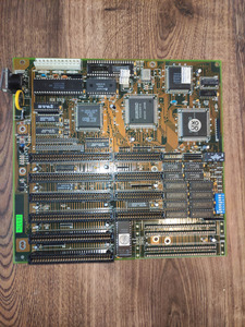

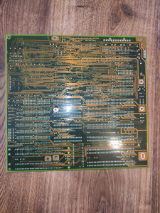

Reply 279 of 288, by Predator99
Dont know where else to post...seems not to be listed in theretroweb:
IPOX IP-4GVI22
