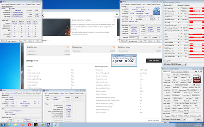

The only thing I'm worried about is Windows XP refusing to boot on a machine with nearly 12GB total memory between System and Video RAM as IIRC video memory counts against the 3.25GB RAM limit on Windows XP.
There is no such thing as counting total VRAM against total RAM pool.
You only get 256MB system RAM reduction per PCI-e GPU (only on 32-bit OS and only if your board doesn't support Memory Remap feature).
Proof #1 :
I present to you, a PC with "negative" RAM (as in, using more VRAM than available system RAM on 32-bit OS) :
442.98 KiB
589 views
FYI : System has 3200MB of RAM available from 4096MB.

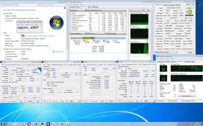

Proof #2 :
RAM check on Nvidia GPU (just in case you think they work differently :
636.56 KiB
589 views
