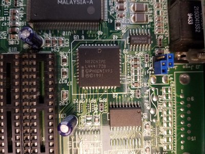

Hi, I have a PB450 motherboard that won't turn on.
The monitor seem to turn on but stays black and I get two beeps.
I already tried changing the memory, disabling onboard memory and also tried to connect external cmos battery but it did not help
Anyone knows what could be the problem?

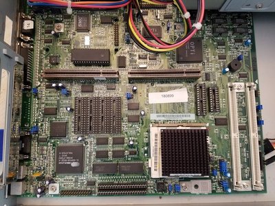

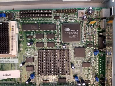

Reply 7 of 189, by ahtoh
Yes I changed J17 back to normal operation of course. I flashed bios for ISA system.
Onboard video is based on CL-GD5428 chip and it is VLB AFAIK
Unfortunately, I have no spare ISA graphics card so I can not verify if it's the graphics card that is faulty.
a few photos attached

Reply 8 of 189, by bjwil1991
Post pics of the motherboard and the whole PC so that way everyone can help you out with the issue. Does the monitor work with another computer?
Reply 10 of 189, by bjwil1991
Remove the jumper (J33) by the PC Speaker (LDEV bypass) since it looks like it's enabled and see what happens.
Reply 12 of 189, by bjwil1991
I see you don't have a riser card installed. Was it installed previously? Also, put the jumper back in. The LDEV Bypass is used for ISA slots.
LDEV Bypass
Enabled --> ISA
Disabled --> PCI

Reply 17 of 189, by ahtoh
Tried to disable J20 - no change. Two beeps.
I don't have any EEPROM programming tool, and I'm not able to locate video bios chip on this board.
I suspect it is in the square chip n82c42pe (shown in the first photo above)
I will still probably be able to replace the chip but don't want do mess with it until I'm sure it is the cause of the fault
Reply 19 of 189, by bjwil1991
That's my guess, too.
