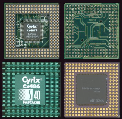

I have a test motherboard which supports the UMC U5SX, i486SX, Cyrix Cx486DX and Cyrix Cx486S. I plan on testing all these CPUs and hopefully the TI 486SXL2 will work with one of those CPU jumper settings. If not, I'll try to modify the board using the guidelines in Appendix D of the TI 486SXL databook.
I know the Cx487S adapter (photo below) should work with the FPU-less Cx486S CPU, however, I'm hoping that it will also work with the SXL2 and U5SX. I suspect it won't work with the i486SX.

Reply 10 of 60, by Anonymous Coward
I know for a fact it won't work with the 486SX, because others have tried it.
Your best bet for the SXL on a socket3 board is to use the jumper settings for the 486S. Both are essentially using DLC cores with extra cache. However, I believe the 486S supports writeback cache, where the SXL likely does not.
Reply 11 of 60, by Nvm1
I second Anonymous Coward, I also have this Cx487s interposer and so far only the Cx486s worked with it.
And the Cx486s uses writeback cache, but not all boards support it/detect it like that.
The settings for the normal 486sx or the Cx486s should have the biggest chance getting the SXL to work. Biggest problem I foresee is that hardly any bios wil recognize them...

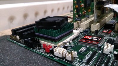

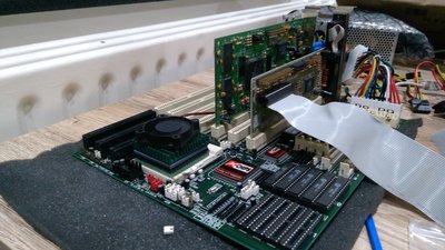

Well, I just peaked on my old phone and found the pictures from the stacked Cx486s and Cx487s with the picture to show it was detected:
1.85 MiB
2499 views
Stacked Cx486s on Cx487s detail
1.78 MiB
2499 views
1.73 MiB
2499 views
Cyrix Cx486s with Cx487s working pcchips M912
It was a PCChips M912 motherboard. Rev 1.7 from the looks of it
Reply 19 of 60, by feipoa
I think I have that motherboard, although mine doesn't have that surprisingly cool looking PC Chips sticker on it. I'll try the PC Chips motherboard to ensure my 486S is OK.
