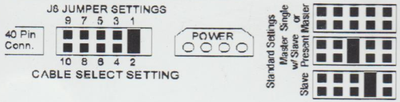

Reply 2 of 34, by SW-SSG
gladders wrote:
... Western Digital HDD ...
Is it set to "single or master" mode?

And, as other said: Check the jumper settings on the drive. ' Single or Master' should work. Try flashing the BIOS to a newer version if applicable.
Not sure how I can do that without using the HDD for DOS to manipulate the floppy drive, as I was using W98 on the P4 machine to do stuff via USB!
