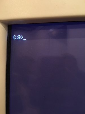

I just installed a Tseng 4000AX video card into a computer running DR Dos 5.0. It is showing weird characters though. The picture below shows what appears instead of C:\>. Anyone know what is going on with it?

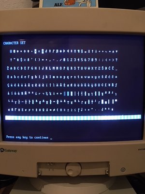

Can you show a full character set?

Reply 2 of 39, by fsmith2003

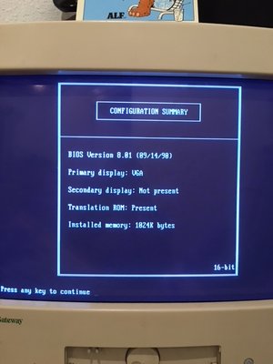

Yes here is the character set and BIOS info:
87.69 KiB
3282 views
106.43 KiB
3282 views

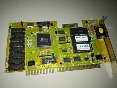

I have a slightly different revision of that card - it has socketed RAM chips (DIP) instead of SOJ packages. It is very fast for a ISA card, but unfortunately exhibits some artifacts under benchmarks (some pixels have wrong colors). Tried it with another set of RAM chips, still same artifacts. How is JP3 set up on your board? On mine it is open, and if I set it to 2-3 the problems are almost gone (but not completely!) and the performance is halved...
Anyway, no problems with the character set, so if you want I can send you a BIOS dump.

I think that bios has ISO 8859 (type 2?) / Latin 2 character set. Your funky character in c:\ is a "D" with stroke in it. very strange it modified characters below 128! usually all codepage changes were 128-255.

That's the Icelandic letter "eth", I think it's also used in some Slavic languages but I don't know what it's called there. I see some other extra slavic characters in there too. Pretty stupid they replaced the \ though; you'd think somebody must have tried DOS on that card and gone "hey..."

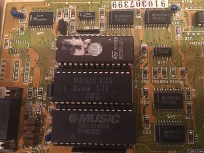

I don't think the chips on your card can be programmed with means other than a dedicated programmer, if at all. On my card, the main BIOS is on a EPROM, and erasing that requires exposure to UV light after removing the opaque label; the SYNC BIOS on the other hand is a mask ROM or a windowless EPROM and cannot be erased/reprogrammed at all.
Please post a picture of your actual card, and maybe peel back a little the label on your SYNC BIOS to see the markings on the chip.

Yes here you go. I do have one of the TL866 programmers on the way. Figured I could use it for some other projects to if it wont work for this. So will I be able to put the new bios on the card at all then or am I basically stuck with the character set it currently has on it you think?

Reply 14 of 39, by Tiido
You definitely cannot program an EPROM directly on the GFX card and none I have seen even has !WE signal so a flash chip wouldn't be upgradeable either (that came along well into the PCI era). 200ns might be too slow too, if you experience weird things with the new chip you'll want to get 150 or 120ns part.
Reply 15 of 39, by quicknick
Same as on my card. The M27256 can be programmed on the TL866, but only after erasing under UV light. Not worth the hassle. The other chip (VGA4000 BIOS) cannot be erased or re-programmed. You need two chips such as these.
Reply 17 of 39, by quicknick
It should. As I mentioned earlier, there's no indication about its size on the "sync bios" chip, so I've read it two times, first assuming it is a 27c256 and then as a 27c512. However, the 512kb image, if split in two, produces two identical files so that should mean the chip is also 256kbit in size.

This is weird... usually it's some TSR program to map different char map. On some cards I saw a switch to select the map.
As some already said, this is a slavic char map. Used in adriatic area - ex Yugoslavia. Most specifically Croats and Serbs use most of the special characters ŠČĆŽĐ. Here we use only ŠČŽ but on my keyboard there are also ĐĆ present.
