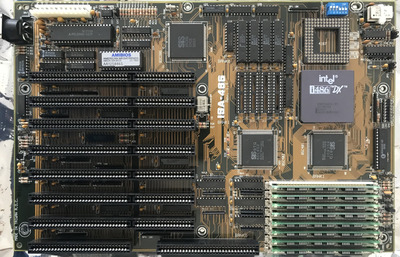

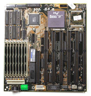

Manufacturer/Identifier: ASUS ISA-486
Chipset: SiS BTQ 85C401/85C402 + 85C206
BIOS/Version: AMI 486DX ISA BIOS 05/05/91
BIOS String: 40-0102-001292-00101111-050591-SIS-486
ISA-486.zip
35.87 KiB
123 downloads

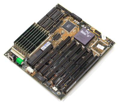

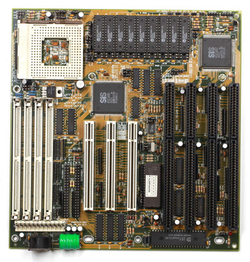

Manufacturer/Identifier: Zida Tomato 4DPS VER 1.0 (PCI400-2)
Chipset: SiS 85C496/85C497 (OR/OT revision)
BIOS/Version: 4DPS VER 1.4 - AWARD
BIOS String: 11/23/95-SiS-496-497/A/B-2A4IBZ11C-00
    517.39 KiB
    3024 views
    4DPS.zip
    84.31 KiB
    112 downloads

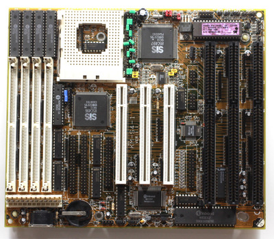

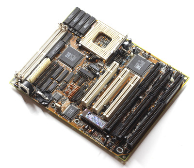

Manufacturer/Identifier: Jamicon KM-S4-1
Chipset: SiS 85C496/85C497 (PR/NU revision)
BIOS/Version: KM-S4-1 VER:4.2 - AWARD
BIOS String: 10/30/95-SiS-496-497/A/B-2A4IBR22C-00
    660.23 KiB
    3022 views
    490.78 KiB
    3022 views
    KM-S4-1.zip
    84.08 KiB
    120 downloads

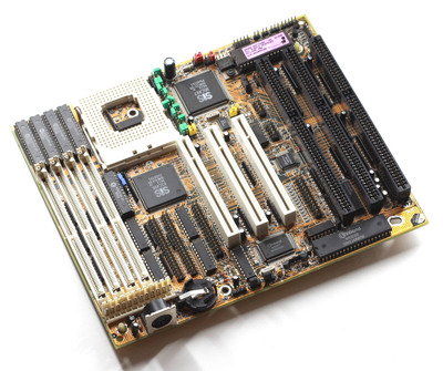

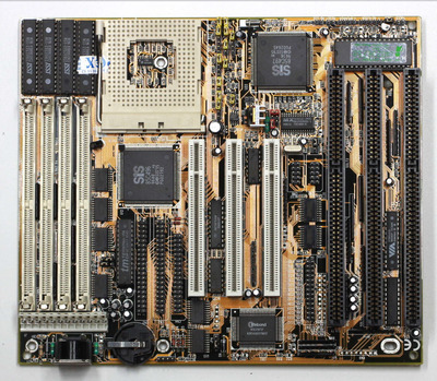

Board ID : LuckyStar LS-486E Rev:C2
Chipset : SiS 496/497 (PR/NU)
BIOS : AWARD 486E 96/7/19
ID string : 03/14/96-SiS-496-497/A/B-2A4IBL13C-00
    854.12 KiB
    3018 views
    607.2 KiB
    3018 views
    LS-486EC2.zip
    85.17 KiB
    107 downloads

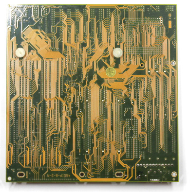

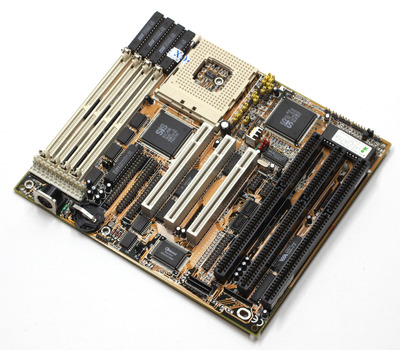

Board ID : 486IP-B-2-A (ABIT PI4/PI4T PCI clone)
Chipset : SiS 496/497 (NV/NU)
BIOS : AWARD 2a4ibb61
ID string : 10/02/95-SiS-496-497/A/B-2A4IBB61C-00
    508.03 KiB
    3015 views
    544.59 KiB
    3015 views

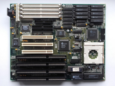

    373 KiB
    3008 views
    ISA-486SIO.zip
    36.05 KiB
    97 downloads
My CPU collection - Looking for hardware in Ukraine - Ukraine vintage PC forum
Reply 86 of 187, by waterbeesje
#86
Aquarius MB4-DUV rev 3.1
Chipset: UMC498F
BIOS/Version: Award, R3.1, dump attached
1.91 MiB
2944 views
pic compressed
MB4-DUV31.zip
2.64 MiB
83 downloads
pic full
MB4-DUV31BIOS.zip
43.79 KiB
96 downloads
bios dump
sidenote: I did part the BIOS file earlier in a different thread, knowing it's probably better of here... But I didn't have a photo of the mobo yet
(BIOS the same as this post: Re: BIOS image collection - requests, discussion etc )
Stuck at 10MHz...

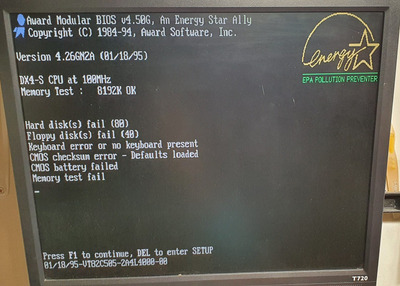

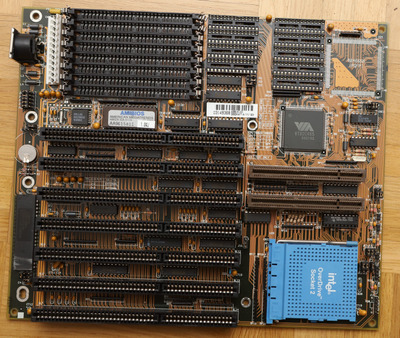

Reply 87 of 187, by AskNotes
#87
Manufacturer: FIRST INTERNATIONAL COMPUTER, INC. ?
Chipset: VIA
BIOS String: 01/18/95-VT82C505-2A4L4000-00
BIOS Version: Award v4.50G Version 4.26gn2a (01/18/95)
    486-VIP-IO BIOS IC dump.zip
    57.89 KiB
    91 downloads

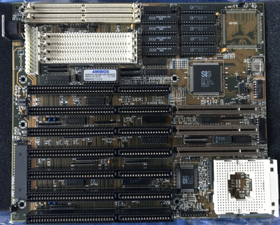

Manufacturer/Identifier: MSI MS-4132 G ver. 1
Chipset: SiS 85C471/85C407
BIOS/Version: AMI 486DX ISA BIOS 08/08/93
BIOS String: 40-0100-001169-00101111-080893-SIS471B

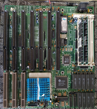

#90

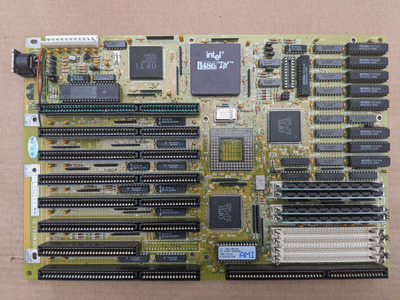

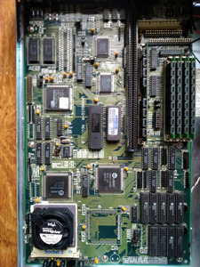

Manufacturer/Identifier: Silicon Valley Computer, Inc 486WB6A3.B1
Chipset: OPTi 82C493/392
BIOS/Version: AMI 486 BIOS ZZ342708, unknown version, BIOS string implies 1991-06-06
BIOS String: 40-0101-ZZ9999-00101111-060691-OPWBSX-F
    486_AMI.zip
    37.26 KiB
    93 downloads
    BIOS obtained using biosdump.bat/memdump.exe
    1.83 MiB
    2847 views
    sorry about the bodge wires

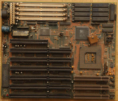

Reply 91 of 187, by SSTV2
#91

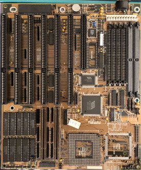

Manufacturer and model: Micronics JX30GP.
Motherboard P/N: 09-00189-10 REV B1.
Chipset:
MIC 471, MIC491;
PC87312VF - Super I/O.
BIOS/Version: Phoenix, 80486 ROM BIOS PLUS Version 0.10 GJX30G-04P, Gateway 2000 Local Bus BIOS.
BIOS date: 09/24/93.
1.13 MiB
2809 views
Micronics_GJX30G-04P_09-24-93.zip
54.67 KiB
103 downloads
Comments:
MIC 471 is a rebranded SiS 85C460 or 85C461 386/486 single chip chipset, MIC491 - SiS 85C407 ISA bus buffer. G and P letters in model/BIOS stands for "Green" and "PS/2 mouse" respectively. BIOS supports power management and PS/2 mouse, but limits HDD geometry to 1024C/16H/63S, thus can't properly detect hard drives larger than 528MB. To enter BIOS setup CTRL+ALT+ESC key combination needs to be pressed after cache size is displayed during POST. Motherboards with P/N 09-00189-10 were used by Gateway.

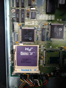

Manufacturer/Identifier: Amstrad PC9486
Chipset: UMC - UM82C481BF/UM82C482AF
Board Type - UX486VIO-A Rev. 1.0
BIOS/Version: AMI 486DX ISA BIOS 1993 - AA9222968

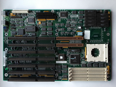

Reply 95 of 187, by Zalog

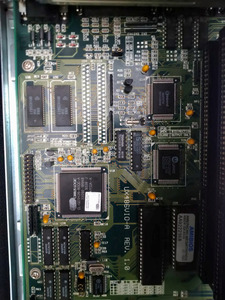

evasive wrote on 2021-04-07, 12:36:
@Zalog: Could you make a picture without the metal support in the middle? Or does that require full disassembly?
Yes unfortunately it requires a fair degree of disassembly - fortunately I took one in the middle of an upgrade so if you don't mind shots of it that are slightly less clear (a bit harder to read the chips at the VGA end of the board) and in non-original condition (added cache chips, overdrive + extra ram) - find attached
892.49 KiB
2721 views
Edit: BIOS String is: 40-0100-001131-00111111-111192-UMC480

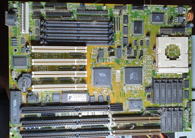

FIC 486-GVT
VIA VT82C486, VIA VT82C482
AMIBIOS 08/08/93

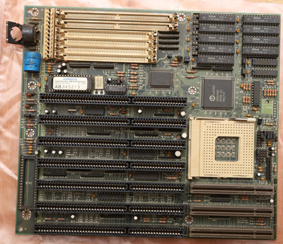

Manufacturer/Identifier: ADI F4DXL-UC4
Chipset:
BIOS String:
http://www.win3x.org/uh19/motherboard/show/5495
1.4 MiB
2554 views
486_AB345213.zip
1.45 MiB
89 downloads

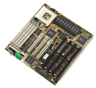

Reply 99 of 187, by Jim5589
Horun wrote on 2020-12-28, 01:54:
#74 Motherboard: Amptron DX9200 AKA PcChips M915i with Fake cache Chipset: UMC UM8881F + UM8886BF EPROM: AMD AM27C010 BIOS Strin […]
#74

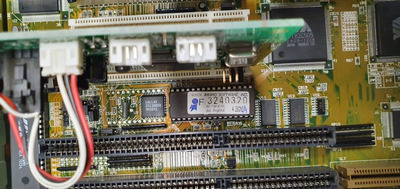

with Fake cache
EPROM: AMD AM27C010
BIOS String: 41-p400-001437-00101111-101094-486AVIP-H
BIOS label: AMI 486DX ISA BIOS 1993
BIOS Version: AMI 10/10/1995: 11-08-1995
CRC 32bit Checksum: 82A4E810
Note: this Fake Cache bios is not same as the M915i BIOS 9151108s floating around.
http://www.win3x.org/uh19/motherboard/show/579
http://www.win3x.org/uh19/motherboard/show/5944
Included the 9151108s BIOS
Sorry if this is a stupid question but I am learning still. I have ended up with one of these boards with the fake cache on it. I plan to remove the fake cache and put some real stuff on it along with the jumpers to configure it. If I do this can I then put the bios on the unit from the links you have posted to make it work properly ?
