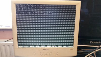

Upon testing the card in other working systems, it will no longer display any output at all when connected to a 16-bit ISA slot. But upon connecting to an 8-bit ISA slot in 2 different PCs, I get this:
1.91 MiB
1149 views
That is supposed to be the IBM ROM BASIC on display there.

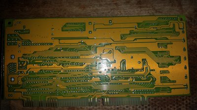

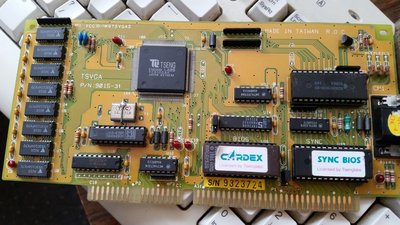

There doesn't appear to be much sign of visible corrosion anywhere on the card itself other than the metal backplate which was exposed to the elements & rusted a little. Though the Tseng marked chip does look a little dirty. I tried cleaning those metal pins on the Tseng marked chip with Isopropyl Alcohol. Made no diffrerence to the card's functional state or lack of it.
Some pictures of the card itself:

Any ideas what may be the cause and what to look for with regards to a potential repair?
I don't want to end up having to recap the entire card or something like that, as this thing isn't really worth too much time and effort. But if there is potential for an easy fix, I'd be inclined to have a go. Can't make it any worse. 🤣
Just for reference, I've done ROM dumps of the 2 ROM chips with an EPROM programmer and they both appear to be fine, so I can rule those out.

Reply 3 of 9, by Tiido
That kind of looks like bad a DRAM chip, since the machine boots and you get things happen the ROMs and ISA side of things works.
What happens when you run some VGA game ?

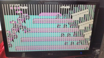

But CGA games I've tested all appear pretty much like this:
1.94 MiB
1074 views
The text in games is readable unlike DOS text mode, but the screen has those white vertical stripes which flicker multi coloured speckles when there's movement and activity on screen. I caught some of the speckles in that image.

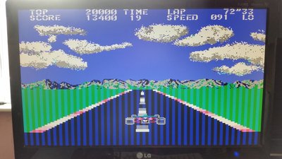

EGA gaming seems to fair better, no flickering on it's vertical stripes:
1.96 MiB
1068 views
Edited to add: I tried the EGA version of Mini-Putt also, which has slight flickering in dark green vertical stripes.

The pictures definitely suggest the fault being in some data line(s) of VRAM bus. Straight vertical lines at regular spacings. Address issue would manifest in repeating graphics.
