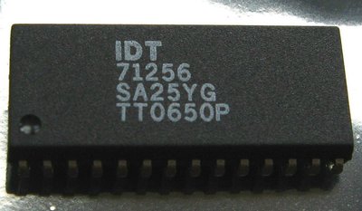

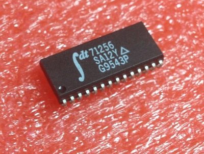

Reply 24 of 56, by amadeus777999
They were ordered via Mouser - 25 pieces since shipping cost(28 Euros) is eliminated of you reach 50 Euros of goods. Customs was a salty 18 Euros, but at least one can buy as a private person instead of a registered company.
I will definitely write to Mouser and see if what kind of "mousings" they'll return.
IF the srams run with 50mhz fsb and the tightest settings then they are on equal footing with the authentic ones... we'll see. The print definitely looks off and can't in any way or form be officially connected to IDT.
The attached images seem to feature authentic chips(different package) and their print is totally different in style.

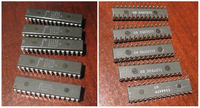

Reply 28 of 56, by feipoa
Here's a photo I took of some IDT 32kx8 SRAM from my stash. Observe the white/grey lettering and the markings on the bottom.
Reply 29 of 56, by amadeus777999
Thanks.
Alliance srams look similar but the UMC ones I have do, for example, not have a bottom print.
The first batch I ever ordered from China also had a white bottom print, so I guess they just relabeled some old srams while the other chips seem to have been newly manufactured and are devoid of any markings.

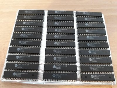

Reply 35 of 56, by Eleanor1967
Today I received these chips which I bought from a german ebay seller which he claims are NOS from a defunct audio company. I don't know if I believe the NOS part because at least some of them look like the have been inserted and pulled before, but at 30 working out of 30 and just about 1.60€ per piece I won't complain. Datecode is from '97.
1.11 MiB
623 views
Again, no affiliation to the seller what so ever, just sharing if anybody is on the search too and doesn't feel like getting scammed by some Chinese ebay seller. "UM61256AK-12 = High Speed CMOS SRAM = 32k x 8 = 12ns !! = SDIP28"
