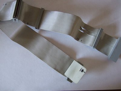

Reply 21 of 52, by Vipersan
So ..dug out an old 1.44mb floppy drive ...and popped it on the end of a multi IDC cable after the twist ..and the mobo boots just fine from a win 98 startup floppy.
but not when the floppy drive is connected by the IDC -before- the twist ..
This I assume is because it is then selected as a B drive.
Obviously this is not an issue normally.
But I also want a 5.25 inch floppy drive in the system.
which only appears to use the edge connector at the cable end.
Thus A can be either 5.25" OR 3.5" ..
But I want both drives in the system ...and connecting the 3.5 as B means I cannot boot from it ..
The Bios allows both A and B ...but only A is bootable.
Is there a way round this ?
Hope that made sense..
Reply 22 of 52, by Vipersan
So ...I am going to try and unclip and move the 5.25" edge connector to the B side of the twist ...leaving the A drive 3.5" IDC after the twist ..
This I hope will give me the configuration I need..
wish me luck.
Reply 23 of 52, by quicknick
Your cable doesn't have an edge connector before the twist too? If not, get such a cable and connect the 5.25 drive before the twist. Usually 5.25 drivers can be set as Drive 0 or 1 (Or A, B) using jumpers.

Reply 25 of 52, by Roman555
There's a cable with both types of connector for A and B FDD
    761.97 KiB
    838 views
Reply 26 of 52, by Roman555
Yes, it could be done. Good luck!
PS But you could use BIOS option "Swap Floppy Drive" instead
