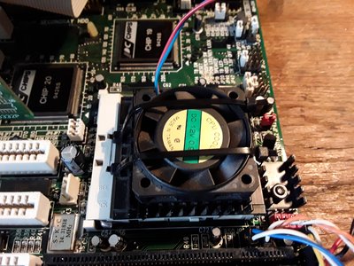

Reply 11 of 19, by ATauenis
Intel486dx33 wrote:
Hello, Do I need to cools 486 ?
All 486s are requiring cooling. Only slowest models like 486SX-25 are too cool to work without heatsink and fan, but they will be very hot, and still may overheat in closed cases with a lot of cables. DX2-66 strongly requires at least heatsink, but a fan is recommended. Top models needs both heatsink and fan (it is even writed on AMD CPUs: "heatsink and fan req'd").
Intel486dx33 wrote:
Can I use a Pentium heat sink with fan and attach it with 3M tape or adhesive ?
It is possible to use Pentium coolers with 486. 😀 Use a 2.5 mm wide nylon screed to fix cooler. No thermal paste is need, but it is recommended.
