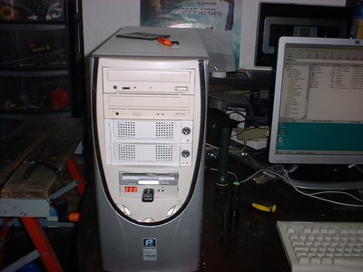

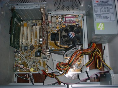

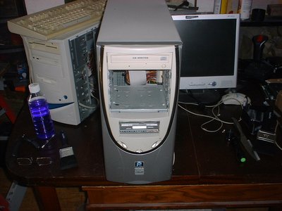

Had to climb in mums loft today to fix a network issue and found what I think was one of my brothers early PCs
Complete with case and psu ..and covered in dust ..
But looks OK underneath the crap..
I will therefore be attempting to bring this one back from the dead.
Here are the main features..
A PC tower atx case with 4x 5.25inch bays and 2x 3.5 inch bays ..
The case I made by Pc Concepts ...and carries a sticker saying powered by Asus.
Has a 20 pin ATX psu connector ..psu made by 'WinPower' ATX 400W
Fitted with a CD writer and DVD rom drives
plus a single 3.5 inch floppy
A7VBX-X mobo with 6 pci slots ...no ISA ...1xAGPX8
1 stick of DDR3 Vdata ram (256 mb)
Intergral sound card.
The graphics card is a bit of an unknown but has VGA port and SV out
Model number NA-52000-TO16 ...passive cooling
Cant see under the heatsink so no idea what the chip is..
Sadly no hard drive ..so cant power it up ..
Presumably removed and re-purposed or destroyed
Only one problem with the has ..it only has 3 feet ..one is missing.
Arctic Cooling fan - copper silent on the as yet unkown CPU
comments welcomed..
..oh and a bonus ..2 boxes of 3.5 inch floppy discs ...
probably around 300 in total ..
I shall enjoy going through these..
Reply 1 of 17, by dionb
That's an A7V8X-X mobo. KT400, iirc. Slightly misleading chipset name, as it couldn't do "400MHz" (i.e. 200MHz DDR) FSB, only "333MHz", but for mid-period AthlonXP CPUs it was a fine platform.
First hit on Google (and no surprise given the model number):
128MB Gainward GeForce FX5200 AGP VGA
Pretty much the least impressive GPU a system like this would have had, but it does the job of getting a picture onto the screen.
Eh? Boot the beast from a LiveCD or LiveUSB. At least that should show you the hardware works.

Reply 4 of 17, by Vipersan
So ..it was going to happen I guess..
Mystery Meat ..has become a Project..
I have cleaned up the case as best I could ..though there are a couple of scuffs and rust spots.
Not sure yet if I will replace the DVD rom and 24X cd writer with a single drive..
but replaced the CMOS battery and a couple of caps ..
It now boots to the Award bios.
I have replaced the 1.44mb floppy with a combined Floppy drive and CF reader ..simply because I had one going spare.
I can now boot to a windoze start up floppy..
Next it required some planning as to what to populate the PCI slots with ..
There is no onboard graphics ..but there is on board sound.
..chances are this will be pants..
I have dug out a Gainward x8 AGP 256mb dual DVI card FX5800 ..to replace that poxy generic card..
It appears to work ..but needs a fan replacement..
I have a choice of 2 mpg accelerator cards
These are sooo similar it is untrue ..but here are differences..
One is made my Creative and uses a CT7235-VBQ ...and the other is Sigma designs REALmagic EM8300.
At this point I'm asking ..is one better than the other ??
..and which will be easier to find drivers for ?
Both appear to require external VGA passthrough ..which might be a problem since the Gainward has dual DVI and no VGA ?

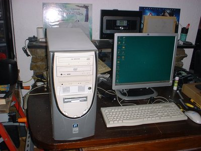

Reply 7 of 17, by Vipersan
So ..everything is now installed ...everything that is except the Realmagic pci card ..
Sadly I dont have an install CD for this ..so not a clue as to how to go about it ..
Advice welcomed ..
My OS is win 98se ..if that helps ?
..and I will most likely have to fabricate a patch lead ..or hard wire it internally..
rgds
VS
Reply 8 of 17, by Vipersan
For anyone interested in the sigma designs 'real magic' or creative equivilant PCI cards
There is a guy on youtube who has tracked down some drivers for XP and one for Win98se
https://www.youtube.com/watch?v=5IZbfBgV4mw
He has made these drivers available for posterity ..since neither Sigma nor Creative no longer host these drivers and basically are no longer available ..anywhere.
I shall be testing them soon..and they are interchangeable between the Creative CT7230 ..and the realmagic EM8300
These drivers are RARE ..so maybe Vogons should host them too ?
rgds
VS
Reply 9 of 17, by chinny22
Be nice surprise for your brother next time he drops round and see's his old PC up and running!

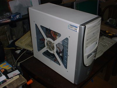

Reply 10 of 17, by Vipersan
TBH I dont think he will even remember it ..
The case has had a re-spray and laquer (rust)
and certainly there is more in it than when he had it..
Including a CD/PD drive ..
A better Graphics card ..
Soundblaster Live ..
A combo Floppy and card reader ...
A pull out caddy for the dual OS ...win98se and XPpro
A real magic mpeg card...
..and a scsi card.
+1gb ram ..with USP3 installed for win98se
The HD is a 200gb drive divided equally for the dual boot operating systems.

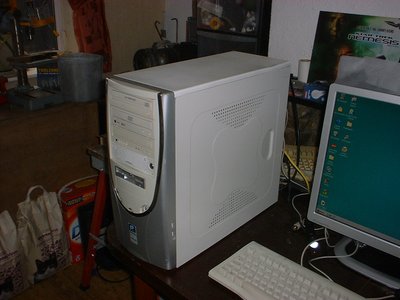

I guess I'm more or less done ..
just one blanked 3.5" slot left for a white Gotek ..
currently on order from China
rgds
VS
..at least now I can get back to my main WIN98se gaming build with an older mobo AMD cpu ...128gb HD ...Soundblaster Live ...and Voodoo 3

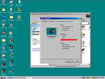

Reply 11 of 17, by Vipersan
So ..I have what I can only describe as a BIOS Mystery ...then again in could be Win98se related..
Having almost completed the build which is looking very powerful insofar as it has all the hardware I planned for it.
I have a curiosity I cannot explain ?
Perhaps one of you guys can ?
As said ..this is a dual boot system ..
Win98se and XPpro
Today I added a Gotek floppy emulator
alongside the conventional mechanical floppy drive.
In the Bios I can enable 2 floppy drives A & B ..
Sadly I cannot set which will boot ..it is always default A:
which is the mechanical ..
Currently B: is the Gotek ..though physically I could swap these.
So ..the bios will NOT allow a boot from drive B: drive though theoretically B: could still be 'seen' by the OS ..
well so you'd think..
Well boot into XP ..and both drives are visible there is A & B in the list..
both drives can display their contents as both are set to 3.5" 1.44mb floppy in the bios..
power down and re-boot into win98se
Only the A: drive is listed ..B: is simply not there ..
rescan for new hardware ...
..still no B: drive ..
Restart in DOS ..and the B: drive (Gotek) is visible as is the A: drive.
WTF is going on ?????
Ok I accept I can only have one floppy bootable ..and it's always the drive after the cable twist..ie..the A: drive ..but why cant 98se see the B drive ..?
DOS can ...XPpro can ?
what is going on ..?
suggestions anyone ?
Reply 12 of 17, by Vipersan
So ..if anyone ever has a similar issue ...this worked for me ..
Scanning for new hardware following the addition of a second floppy ...
Total waste of time..
Win98se aint smart enough to pick it up ..
However ..
going into Control panel ..and removing the FDD controller completely ..then rebooting so win98 is forced to find it again ..
Well ..it does ..AND the added floppy drive is also found..
Nice 😉

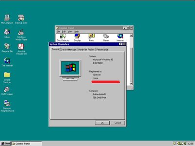

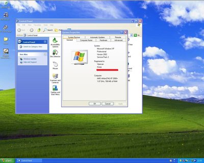

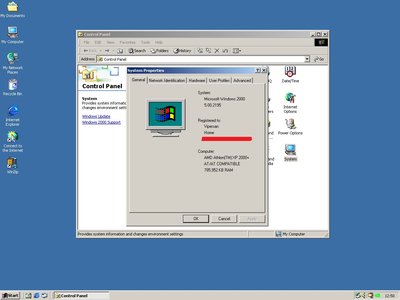

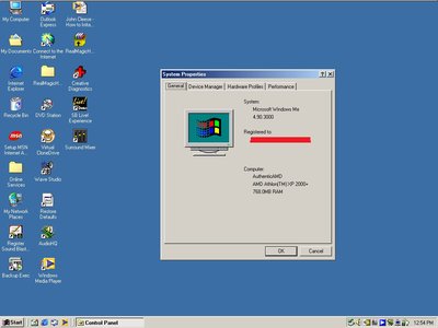

Reply 14 of 17, by Vipersan
Progressing very nicely 'Mystery Meat'.
Still waiting fo a replacement fan to fit the FX5600 ...
I have 3 on order from China.
(slow boat) 🤣
However ..in the meantime I have been building dual OS's for pull out IDE caddies.
So far I can dual boot either XPpro or Win98se
and by swapping out the HD tray ...dual boot Win2000 or WinMe.
Win95 is being a PITA ..most likely because the ram is excessive ...or the CPU is non compatible ..or too fast.
Not given up yet though.
I have now installed an extra USB pci card ..which accepts a thumb drive or a Logitech 310 usb game controller ..

Finally got a stable Win95C OS for mystery meat ..
I even persuaded my old copy of Veritas Backup Exec to run on it ..
Very useful during the experiment and build stage..as I can backup the whole system as I go to DAT tape using the external DDS drive via scsi.
This software works best on win98 ..and can be a pita on win95
It turned out I can remove the serial mouse and connect my optical PS2 when all other hardware and devices have been installed ??
The crashes and lockouts are evident during the build phase..
resource conflicts I guess.
I can now read/write the contents of a usb thumb drive ...but absolutely no way use a USB game controller..
I guess too new even for 95C ...so no HIDs for me
The fast cpu patch makes it at least possible to run 95 on a mobo which really was designed for 98 ..and XP (just)
So that's 5 pull out working OS ..
Win95C
Win98se
WinMe
Win2000
WinXPpro
win2k and Me are dual boot on a 120gb HD
XP and 98se dual boot also on 120gb HD
Win95 on a 40gb HD
Hardware used is
pci SCSI - with external DDS tape drive
CD RW /DVD
CD/PD
Floppy drive with card readers..(card readers dont work in 95C- usb connected)
Gotek Floppy EMU
Gainward FX5600 Graphics card
RealMagic graphics pass through Card
Soundblaster Live
Startech 5 port USB 2.0 pci (4 ports and internal pin header)
Specs atm :-
768 mb ram
AMD ATHLON XP2000+ 1.67ghz
Not bad I guess for a 'Loft Find' a few weeks back.
..still waiting for a new fan to replace the noisy unreliable gainward GPU fan ..
still ..all but done .
