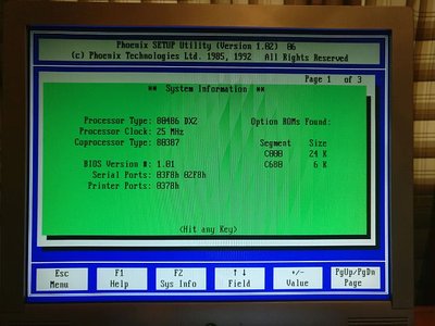

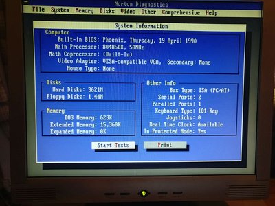

According to Norton Diagnostics, the CPU is a 486 DX-50, but according to the BIOS it's a DX2, running at 25MHz, which as far as I understand it can't be right. If it is a DX-50, then shouldn't the FSB be running at 50MHz? Where does the 25MHz come from? Wouldn't that make it a DX2-50? Because that doesn't exist does it? Am very confused.

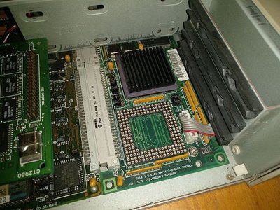

Speaking of the CPU, it seems to be on some sort of daughter-board, and there's even room for a second CPU by the look of it. I've never seen this sort of set up before. If anyone knows where I can find info on this board or how to configure it, that would be really useful.

Reply 3 of 11, by LeFlash
The other socket is most likely for a 487SX Coprocessor. Useless with your DX-setup.
Fun fact: The 487 included a complete 486. Just an extra pin checked and disabled the 486 in the main socket.
Using the 487 alone did not help as it checks the presence of the main cpu.

Phreeze wrote:
dx2/50 exists 😉 i still have our old one at home
So it sounds like it's a DX2-50, running on a 25MHz FSB. That would certainly explain the sluggish DOOM performance. Thanks for the heads up!

Reply 10 of 11, by The Serpent Rider
That's a socket for Overdrive ODP with one extra leg to disable your current CPU. I think this board will ignore anything else in this socket even if you remove current CPU.
