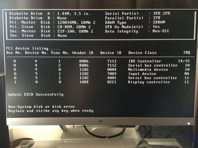

How do i check is devices are sharing IRQs or not ? I only have the 6200 in the AGP slot and my sound card in the PCI slot, nothing else is installed.
Will have to have a look on Ebay, being in the UK the pickings for old hardware is not as good as the US, Hell a voodoo 2-5 cost between 80-300 here 🙁
Reply 45 of 70, by canthearu
Normally as the computer is booting through POST, it will list the devices and the IRQs they are assigned. You can use that to make sure that the SB audigy isn't on a IRQ with another device.

When the computer starts it first shows the 6200 with 512mb ram, then I get my memory check with what drives I have as master and slave...after that it just boots into windows 98se another screen does show but only for a second.
Reply 48 of 70, by Auron359
canthearu wrote:
Set the bios to boot floppy first and put a non-bootable floppy in. Then you will get time to see the screen.
Here is my pic device listing with all the Irq numbers.
Hope this helps.
Reply 49 of 70, by canthearu
Disable USB in your bios, then verify that IRQ 10 and 11 are now only on single devices.
Then see if your problems with sound/video improve. You will obviously need to use a PS/2 keyboard/mouse.

No, you need to disable the USB controllers entirely.
Goto PCI configuration on the Advanced tab of your BIOS and change USB IRQ from enabled to disabled.
If this fixes your problem, you can change settings around on this screen to select an appropriate IRQ for your sound card.

Ah I have no idea what’s going on, disabling the usb removed on IRQ of 10 but that is all.

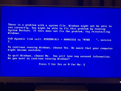

Well i have good news, i moved my sound card and everything seams to be working fine, Windows ME installed without an issue ( will mod it later to add full ms-dos support )
However i still have one problems left I need help with 🙁
Upon every start up i get a blue screen error message (pic uploaded) Selecting yes i boot into windows ME no issues 😖
Also when I try to shut down the PC i just get a blank screen with a flashing underscore looking thing.. dno if it is related or not but these are my last problems.

Reply 58 of 70, by canthearu
I think the blue screen you are getting, as well as the failure of the computer to shut down properly, are due to the Nvidia 6200.
At the very least, the failure to shutdown problem is a known bug with later win9x nvidia drivers.

The error is an odd one, looked on google and people were saying it is due to the network card.. I dont have one, or bad ram again :s
