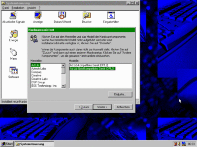

Reply 11 of 23, by Jo22
Muz wrote:
I ran the utility in Windows 95, but nothing happen. Just a blank program.
I'm not surprised, Windows 95 has medicore MIDI support (in comparison to 3.1).
I'd try the Voyetra Super SAPI: http://soundshock.se/phpBB2/viewtopic.php?t=454
Alternatively, just install one of the OPL3 drivers supplied with Windows95.
