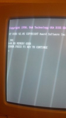

every time whitch power-on my old 8088 pc obtain a error after memory check. "ERROR.PRESS F1 KEY TO CONTINUE".
If I push reset button or ctrl-alt-canc I don't see the error message.
I changed the cmos battery and I voltage it's ok with tester, 3,7V.
In attachment the photo.
Please, what can I do?

Error 301 -> Keyboard error.
Maybe your PC is trying to initialize your keyboard in an unexpected way. Keep in mind that XT and AT keyboards are different, and some AT keyboards won't support XT protocols.

OK, but I can press F1 key and boot the os and I can interacting with PC. The keyboard seems to be XT because there aren't windows keys and the connector is old DIN.

Maybe the keyboard is initializing properly, but it gives a response that the motherboard doesn't understand (or don't give a response in time). I have a ZX Uno (a FPGA based sytem that can be configured to run as various systems), and some "cores" (=systems emulated) had various problems due to bad initializations (i.e.: keyboards that works at power up but fails when rebooting, keyboard that only works after reset or keyboards that don't work at all).

As you state that the keyboard is functional and you're able to boot the OS etc - is the keyboard perhaps an auto-sensing one, where it can automatically detect and work on both XT & AT class computers? If that's the case, then maybe it is defaulting to AT mode and not switching to XT mode in time for when the BIOS initially checks it. Would possibly explain why a reset clears the error, as the keyboard would already be initialised in XT mode.
Not sure if there's much way around it, though you could try switching to a different BIOS, ie. the Turbo XT BIOS. That would require replacing & programming new EPROM or EEPROM chips though.

But a better way is to find a better keyboard with mechanical AT/XT switch or even an old XT Keyboard.

Thank you for the many answer. At this point I think the problem is the keyboard how explained from @PTherapist. I'll try to search a pure XT keyboard.
