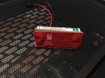

As usual: did you already think about removing that barrel battery? Considering its age it will start at some point leaking! There are lots of different options to replace it with. 😀
Nowadays I simply use an AA shaped 3.7V Lithium battery with a diode to prevent charging on a small raster board.

Reply 16 of 25, by root42
treeman wrote:
I had a moment a few weeks ago when I desoldered all the barrel batteries from all my old motherboards and at exactly that time I was putting this board in so as a temporary measure I removed the battery on this board, soldered in 2 wires maybye about 5-6cm long soldered the barrel to them and twisted to the back of the case away from anything important.
would you be able to post a picture of your setup? I would be interested as what I have is temporary but safe
I recorded a video of the battery replacement I am now using in my 286:
https://youtu.be/seCoC2AcHqs
I have later cut off the excess raster board and used double sided tape to glue the whole thing to a safe place in my case. However, I will probably 3D print a small enclosure at a later point and use that for extra safety.
757.67 KiB
1732 views
YouTube and Bonus
