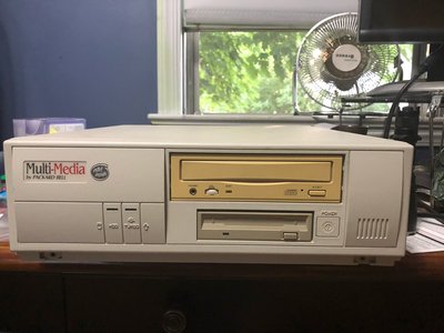

Can you post pics of the Packard Bell?

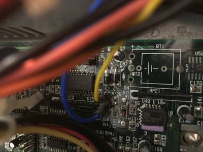

Reply 15 of 27, by df00z
Little bit of corrosion where the bios battery was. Wondering if this is why the floppy conttoller is no good?
I can’t disable the floppy controller, it won’t boot off the hd if I do that.
Reply 16 of 27, by df00z

Reply 17 of 27, by bjwil1991
Glad you got it sorted. Were you still unable to boot from a floppy?
Reply 18 of 27, by df00z
Correct. If I try to boot from a floppy it hangs. If I put in a controller card for it and disable the onboard it hangs. If I disable the controller and try to boot from a hd it hangs.
I have to leave the floppy controller enabled even though it is non-functional.
If I boot and go to a: it hangs
If I put no disk in and force it to abort\retry\fail on accessing the a drive the screen flickers off and the power supply starts buzzing.
There is some sort of hardware or severe bios issue, but it runs.
Reply 19 of 27, by chinny22
I doubt you'll miss the floppy these days with all the alternatives like CD, Network, even the CF card can easily be put in another machine.
With the roland in the pic looks like you have a nice 486 in the making, look forward to see how it ends up 😀
