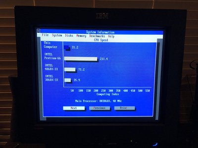

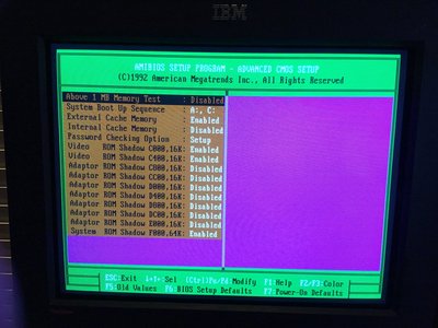

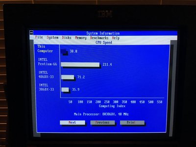

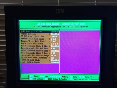

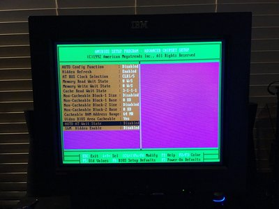

Reply 48 of 72, by aquishix
kixs wrote:
Most BIOS's have different options. What I'd like to see is what options are there. Therefore pics are good 😉
I've attached 5 images. The first two show the two relevant BIOS screens with BIOS defaults. The third is an image of the Symantec system benchmark resulting from those settings. The 4th and 5th images show the best BIOS settings I could come up with, and the resulting benchmark results.
NB: I know I should've changed that 64MB cacheable RAM amount to 4MB because the system currently has 4MB in it; I did that after I took these pictures and it made no difference in performance or anything else.
Couple of other things to note:
1) I received that ET4000 card today, ahead of schedule. I installed it and it definitely improved the video performance, but it didn't have any(at least not much) visible impact on the speed of Warcraft I. It just seems to speed up text being displayed to the screen while in 80x25 text mode in DOS, the BIOS menus, and the POST screen.
2) I took out 4MiB of RAM from the previous 8MiB total, ran the benchmarks (and played Warcraft I) and saw no change. I swapped in the 4MiB I had removed instead, with similar non-results. So the RAM doesn't appear to be a problem.

Reply 49 of 72, by konc
It's dead simple: Unless you change your "Cache Read Wait State" to something that doesn't start with 3-x-x-x, you're stuck with low 30s in sysinfo.
Yes, I'm 100% certain about this, just this setting and nothing else. And no, I don't believe that you tried 2-2-2-2 "but had no noticeable impact on performance". Try it again please.
(Apparently your cache can't cope up with 2-1-1-1, your RAM can with 0 WS)
