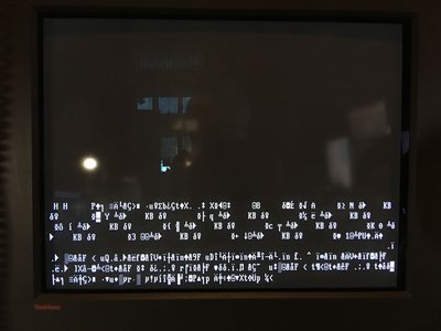

Here's what I see, post-POST, when I set the timing to 2-2-2-2.
    170.05 KiB
    671 views

Have any of the owners of this board actually tried to attach a coprocessor to it? I ordered IIT C87-40Mhz and when I mounted in on the board, the system started and shut down immediately. According to the boards specs it supports NPU, this https://stason.org/TULARC/pc/motherboards/I/I … OPTI-495SX.html says 80387? Will intel 16-33 FPU work on this? I see 14MHz quarz nearby, or is there any secret jumper that should be changed to make it work? I don't see a option in Bios to enable/disable it to I assume it does everything automatically. Two bioses exist for the board 1.2 and 2.0 and I tried both of them with the same results. Anyone got lucky about this?
