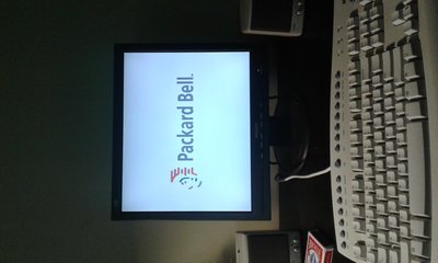

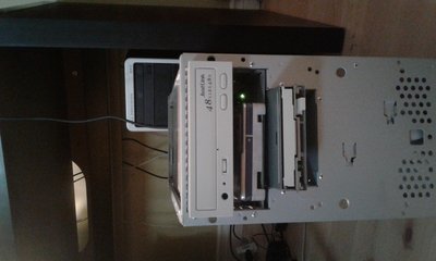

I found this PC on the side of the road yesterday, and took it because it looked interesting, despite having no front or side panels. 😒 The BIOS screen shows the PB logo, and there is a PB OEM Windows ME key on the back. No other stickers, nothing.
Specs:
Some s478 intel based motherboard.
1.6 GHz Pentium 4
256 MB RAM
1.5 GB HDD
Oddly, there are no serial numbers ANYWHERE on the thing. Any pointers?

Sure about that motherboard? With a PB BIOS it's obviously a PB board, but that Intel OEM doesn't sound right for that era.
See the bottom block of "MPGA" boards for So478. With an i845 I'd expect it to be a GA8IDMNF or MS6506.
As for S/N, that might have been on the missing plastic casing. Could you get a pic of the rear of the system?
Also check the side of the bottom expansion slot for a P/N.
