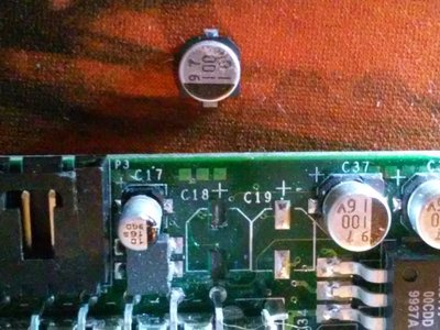

Though, it turns out I may not need a MB anyway (smoke seems to have all come from fried speaker wire.) Just discovered a surface mount cap on my Voodoo 3TV that was half off (now is fully off, see pic.) Something must have happened during one of the many moves I had to make over the last couple of years 🙁 Right now, the system is booting with a temp AGP video card & PSU. More testing to come.

Finally, anyone capable of repairing a V3 with this problem? Barring that, I'm going to need to either get a replacement V3 or find an alternative graphics card that has drivers for Windows 3.1 (yes, 3.1.) I went through several before I got to this Voodoo card, and all had one problem or another. Sort of like to find one that is 100% VESA compliant as well, if that is possible.

Pretty much any local workshop can fix surface mounted capacitor.
Reply 3 of 7, by cyclone3d
Looks to me like the pads are off.
Also looks like the traces are on the same side of the board, which is definitely a good thing.
Just have to expose the copper in the traces and then solder to them.
Pretty easy fix.
Any repair shop should be able to fix that in a few minutes if you don't want to solder it yourself.

With my tremors, no way I could do that, and Waco doesn't appear to have any form of workshop that does that kind of work 🙁 A couple of place have someone willing to do soldering work, but only basic stuff.

Well, if you don't mind paying for shipping both ways, I should be able to fix it. Send me a PM and we can discuss.

You can bodge it and any repair shop is going to do the same thing anyway, as for central Texas I have a deep loathing for this place.
