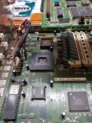

I have been rebuilding my first ever pc, after finding it in storage again, and I've gotten to the point of turning it on and getting ready to throw dos on it, when I saw it start plastering the screen with keyboard characters. Slashes or equals signs usually. Every line, every character space. I personally think it's an issue with the graphics chipset on board, but I don't have an ISA graphics card. Though I have heard suggestions of CPU issue or even bios battery. I figured I would ask what all of you think before I continue with the rebuild.
I tried to attach photos but apparently my camera shots are too big for the 2mb attachment size limit so I've included Dropbox links. I hope that isn't a violation of posting rules.
https://www.dropbox.com/s/e0675iwqidd8x1f/201 … 185653.jpg?dl=0
https://www.dropbox.com/s/ud0rl8gipn2jwpb/201 … 185849.jpg?dl=0

Photos of the pc innards?

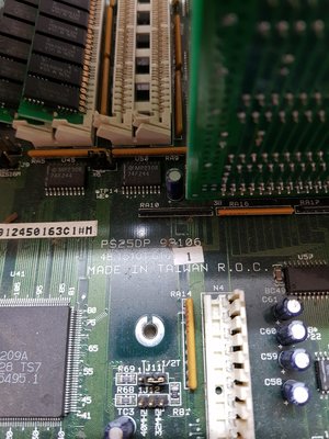

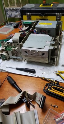

Was actually curious as to identifying this thing while we're at it, I suspect it was originally a Frankenstein build before I got it, as there's some impressive solder work on the board. As for photos of the internals, I've done the best I can but disassembly of this case is... Well I was going to sum it up with a witty remark but then I remembered there's rules about keeping it civil, so let's just say I'm not going to disassemble this thing at midnight. 😜

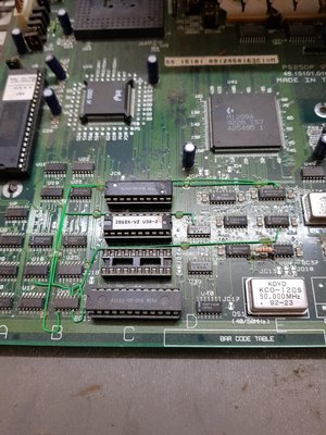

I could not identify the bios chip, I suspect it may be hidden under the power supply. I've attached all the photos I could get clear enough without exceeding the upload limit, and I couldn't see any switches.
As far as cpu goes, I'm pretty sure it's an on board Intel 8088, but the ram is a mystery. I was hoping that bios could tell me how much it has installed, as there are no identifying marks at all on the Simms. There is no graphics card, only onboard vga. I installed the speakers, cdrom, soundcard and compact flash adaptor.
As I implied, information about this thing is extremely limited. The only thing I can tell you for certain is that it has a sticker on the base that claims it to be an alcatel 8551.
Oh and according to post preview, the fourth photo is upside down, I don't know how that happened as its right way up on my phone.
In your pictures there are chips marked 386SX-25, so it'll be a 386SX running at 25MHz.
With regards to the garbled video output, I had a similar thing with an ISA graphics card and it was suggested here on VOGONS that faulty Video RAM could be to blame. That sounds like a logical cause and if you're lucky you might have socketed video RAM chips that you could try replacing. But getting an ISA Graphics Card may be the easier option overall, assuming this motherboard doesn't act weird and force the onboard graphics as default regardless.

I'll have a hunt around the next time I have it open to see if the chips are socketed. But then again I have hardly any idea which chips are what. Google fu, don't let me down!

Spotting memory chips should be easy - look for a couple of identical chips. ISA cards typically have some kind of 44256 chips and hopefully you M/B too. These are very standard looking 20-pin chips, usually having something like -7 in their markings (ns speed rating, very common 70ns in this case).

For anyone following this still, I recently solved this issue at last, it turned out to be a faulty video ram chip. Since identifying the issue, I've managed to get it running 2D games, though it's far from finished. Many thanks to everyone who offered suggestions here 😁
