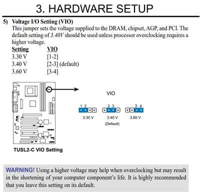

Is there any downside to changing the VIO jumper from the default 3.4v to 3.3v?
I haven't thought about it before, but noticed it today in the BIOS (HW monitor shows
+3.44v). I measured the +3.3v from the PSU (3.32v) before finding out about the jumper.
Did Asus set it to 3.4v to improve overclocking stability, or is it needed at stock speed?
I'm asking since I don't want to fry my Voodoo3, SB-Live, HDDs etc.

Reply 1 of 6, by derSammler
It clearly says that you should leave it at the 3.40V setting. It's common that voltages are a bit higher since they drop once the power rail is loaded. This way, you get the correct voltage. You can probably lower it if you haven't much load on the 3.3V rail, but +0.1V won't kill your hardware, while -0.1V may cause instability.

Thanks for the reply. You're probably right.
I just find it strange that the 3.3v setting is there, if it's not needed. The voltage reading is higher compared to other motherboards I have (Abit BH6, Aopen AX6C, Fujitsu Siemens D1215, Abit IS7-E and E2 etc).

If it's stable - leave it at 3.3v. Undervolting never hurts.
ASUS made 3.4v as a default value for overclocking headroom. Which is blatantly stated in the manual.
Are we looking at the same manual? Because it states the opposite. You should leave it at 3.40V unless processor overclocking requires a higher voltage (which would be 3.60V then).
It does not mention nominal speed at all and only warns about risk of using 3.6v to improve overclocking. 3.4v is assumed as safe to use value for overclocking.

It's a bit confusing, and having 3.4v as the default is like saying "leave this 1.4GHz CPU
at the default 1.45GHz" 😉
(since 3.3v is the standard for I/O)
But as derSammler said, perhaps it's just a compensation for voltage drop.
