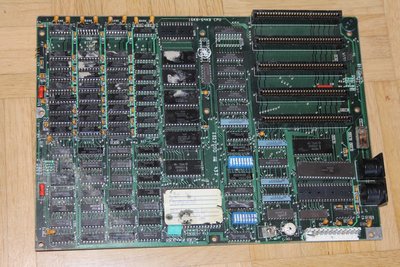

It was about this board:

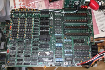

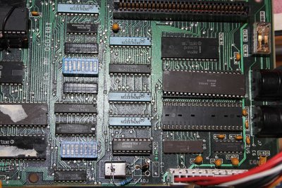

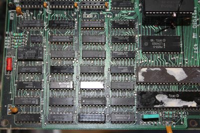

In the mean time I have
- cleaned with a toothbrush
- (temporaly) replaced the crystal and the 8284. Now my Mutlimeter shows 4.77 MHz on the ISA bus
- added missing CAP on C7
- replaced the CPU
665.92 KiB
1210 views
609.76 KiB
1210 views
682.21 KiB
1210 views
But still: Nothing 🙁
Therefore I assumed a bad BIOS. I build this adapter
https://www.elektronik-technik.biz/liste/%234 … rs/READ2364.gif
And read the ROM in my TL866 and the image its exactly the same as the one found in the net. Therefore the BIOS is OK.
For further diagnostic I build the opposite adapter to use the Supersoft ROM:
http://minuszerodegrees.net/5150/motherboard/5150_u33.htm
This is the construction you see on the photo 😎 I verified this with the other Adapter and it works.
But also with the Supersoft-ROM: Nothing. No Beep, nothing on the CGA.
Somebody has an idea where to continue? I suspect some of the logic ICs as some seem to be rusty (as U62 / U79)...but I cannot desolder one after one and check them?

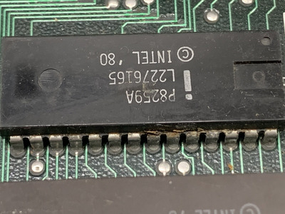

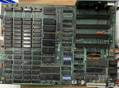

I recently was given a 5150 with a 16K-64K motherboard labeled "1840401 456 XM "
Seems dead. I know that a regular diagnostic card isn't fully useful, but when I put it in, I see the LED lights flash for a fraction of second and then go black.
Looking over the board, there was a rusty lump sitting on the side of the P8259a chip.
Could the repair be just as simple as replacing this chip with a generic replacement ?

Reply 14 of 20, by douglar
I'm going to try the repair.
If it isn't successful, did any vendors make 3rd party boards that fit a 5150 case?
Looks like this one might have the right slot spacing: https://www.ultimateretro.net/en/motherboards/10191

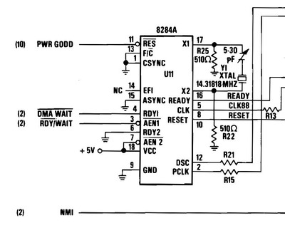

Reply 15 of 20, by douglar
Looks like the rheostat looking thing is by the power is broken, since 1the top /2 of it fell off.
71.34 KiB
664 views
A 5-30 pF clock chip trimmer ?
http://www.minuszerodegrees.net/5150/misc/515 … ch_settings.htm
Looks like I only need it if I am doing CGA, yes?
Reply 16 of 20, by snufkin
Looks like it acts as a calibration for all the clocks:
http://www.minuszerodegrees.net/5150_5160/mis … _generation.jpg
From the schematic you can see it's in series with the main 14.318 crystal:
53.73 KiB
659 views
So if it's failed open then the clock won't run.
Reply 18 of 20, by snufkin
