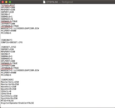

Reply 2 of 21, by Ageve
Check the IRQ/DMA-settings in Windows 98se, and make sure there's no conflict between the emulation settings in DOS, and the "real" IRQ of the soundcard (or DMA of other hardware).
Use the settings from the "SB16 emulation" driver in Windows. It has always worked for me.
The DOS settings are stored in C:\drv\creative\dosdrv\ctsyn.ini.
Then change the SET BLASTER values to match the ctsyn.ini, and it should work (if the motherboard/chipset supports it).
    187.62 KiB
    1678 views
Reply 3 of 21, by Vipersan
Sadly ..I'm still getting the same conflict error ...but maybe I need change more than just editing the ctsyn.ini
This is the version I had in creative Dos drivers ..
[ctsyn.drv]
OPLPort=388
MPUPort=330
SBPort=220
SBIRQ=7
SBDMALO=1
SBDMAHI=5
SBEnable=true
JoyEnable=true
Waveset=C:\WINDOWS\SYSTEM\default.ecw
PCIPort=d400
PCIIRQ=9
JoyPort=200
This is ctsyn.ini copied directly from Win98se (which works under windows)
[ctsyn.drv]
OPLPort=388
MPUPort=330
SBPort=220
SBIRQ=5
SBDMALO=1
SBDMAHI=5
SBEnable=true
JoyPort=200
JoyEnable=true
Waveset=C:\DRV\CREATIVE\DOSDRV\default.ecw
PCIPort=1000
PCIIRQ=11
[SBEMIXER]
MasterVolL=192
MasterVolR=192
WaveVolL=192
WaveVolR=192
CDVolL=192
CDVolR=192
SynthVolL=192
SynthVolR=192
MT32=-
This is the edited ctsyn.ini ...with which I overwrote in the DOS instalation which fails..
[ctsyn.drv]
OPLPort=388
MPUPort=330
SBPort=220
SBIRQ=5
SBDMALO=1
SBDMAHI=5
SBEnable=true
JoyEnable=true
PCIPort=1000
PCIIRQ=11
JoyPort=200
...............obviously I am missing something important or totally misunderstanding something ????
rgds
and thanks for trying to help btw.
have I missed anything ?
perhaps the order is important ?
perhaps I need to edit something in config.sys as well ???

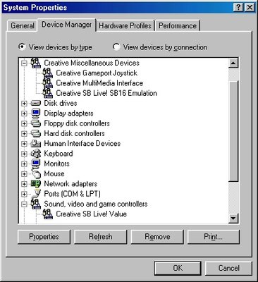

Reply 4 of 21, by Ageve
Check the settings in Windows Device manager as well (both for emulation and the actual card). I'm not sure if Windows uses the settings in ctsyn.ini.
These should match the hardware resources for the SB Live! in Windows:
PCIPort=1000
PCIIRQ=11
Also make sure the IRQ/DMAs for DOS emulation aren't used by some other hardware in the system.

Reply 8 of 21, by Ageve
Vipersan wrote:
It could well be this Asus notherboard will never work with SB Live & pure DOS..
Yeah, it seems like it won't.
What settings for PCIPORT and PCIIRQ did you end up using? They were different in the two ini-files above, and they need to match the real hardware address and IRQ.
You could disable COM, LPT etc in the BIOS as well, but it's much easier to just check it in Windows. In DOS it's like finding a needle in a haystack 😉
