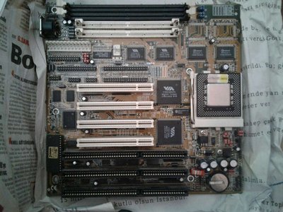

The board I'm considering buying is the one attached, is this a 512K board? Would using it in WT mode for 128MB RAM be worthwhile for playing games up to and including 1998 compared to a TX board with 64MB RAM?

Reply 13 of 14, by dionb
That photograph's too blurry to make out the cache chip markings, so can't say, but it's highly unlikely to be more than 512kB.
Not sure how easy it is to find decent (and decently priced) hardware where you are, but as I said, things were moving very fast in 1997. A board like this would have been great in early 1997, but irritatingly dated/low-end by late 1997 and far more so by 1998. For a 1998 build I'd strongly suggest going with a 1998 chipset such as the ALi Aladdin V or Via MVP3, or at least a late 1997 one like the ALi Aladdin IV, SiS 5581 or Via VP3. That gives you a bit more performance, more bus speed options, decent SDRAM support and more cacheable area.
