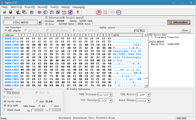

I read the ROM as you said, but the code was present two times and with lot of margin space, first from 0x6000, second from 0xE000. It is saved though so I can burn it back if something goes wrong.

Reply 5 of 11, by Predator99
Then its actually a 27C256, half the size. The image you read is correct, but includes 2 copies.
74S287 is most likely a logic IC (74LS287), you can also check it with the TL866.

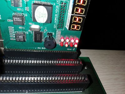

Indeed, than the beep indicates a short. Leave CPU+ROM uninstalled until fixed. Check the pins on the back if some are touching each other. Check the power lines on the ISA bus. Buy a POST card 😉

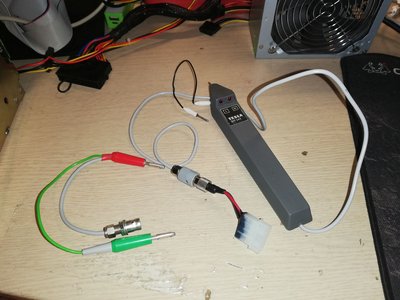

Today I made myself an reduction for my logic probe, so I hope some action happens now. Sadly, I start to point at the UMC chip, seems to be messed up.
